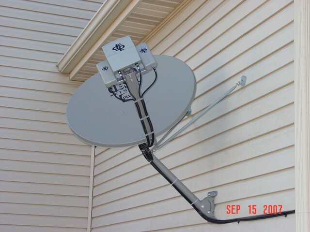

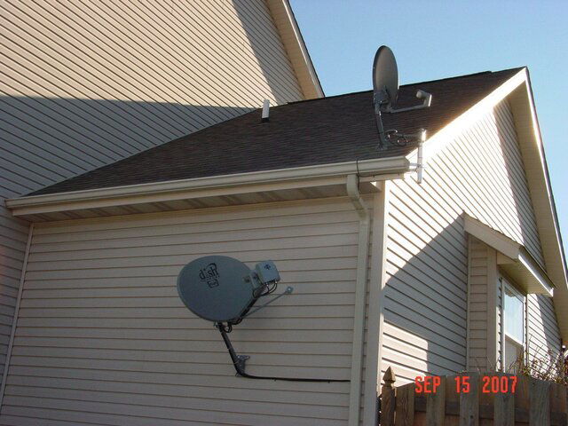

Check this vinyl mount out. My retailer gave me the mount for a 1000+ before he ever came out for the install. I figured out exactly where it would go on the wall. Peeled up the vinyl and marked where the studs were. Under the bowed out air space of the vinyl installed 1/2 inch of OSD (I think it is called) where the mount lag bolts would be on the studs. The mount foot base center bolts are spot on center of the studs and so are the two support struts. It is mounted flush and no bowing in of the vinyl.
Sweet! Nice installation!

We can't mount to vinyl at all. The problem is that the dish locks the sidding in place. When it gets hot it can't move like it is supposed to. That is when it pops loose from the other rows. It will be 10 feet away from the dish and the vinyl is falling of the house.
yeah, thats why they leave the siding overlapping a few inches... as the siding gets hot or cold, it expands or shrinks and needs to move a little bit

Not to mention that a roof mount should not be done over a living area, but instead should be mounted over the eaves so that if there is a leak, it doesn't leak into the house.

I don't know how much the siding wants to move, but here's an idea:
Remove the dish including the 'foot'. In your siding, you have (4) holes that are the size of your lag bolts right now. Drill out the holes in the siding only so that they're bigger. The extra room might allow the siding to shift now.
Now, if the various components you're using 'clamp' things together completely, this won't help.
The footing has 6 holes. Four corners and the two in the middle that are on the stud. I think I am not going to do anything and see what happens and then deal with it. Maybe it will be ok. What do you think?
You MAY be OK with your installation! From your photo, the 6 mounting foot bolts are in the middle of a fairly short piece (6 to 8 ft.) of what appears to be "double-four" inch dutch lap siding. This will allow that piece of siding to expand or contract horizontally to the left and the right of where the bolts penetrate the siding.
Some general rules for vinyl siding are:
- Vinyl siding is "hung" on a wall - nail heads do not clamp siding to surface
- A long (12 foot) length of siding will expand/contract more than a short (4 foot) piece
- If the center of a piece of siding is "clamped" to wall it normally isn't a problem - it can still expand left and right
- If however if a piece of siding is "clamped" on the left or right end, ALL of the expansion will be to the end opposite of where it is clamped.
I would't change anything right now! I would keep an eye on it through very cold and very hot/sunny weather and see if there's a problem.
Good luck - nice installation and even nicer home!
