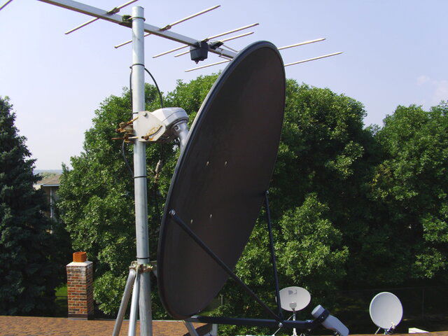

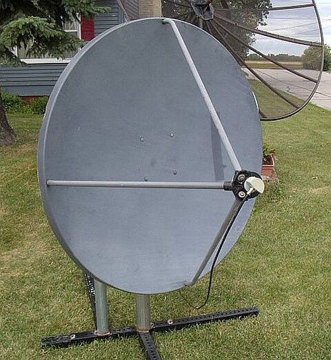

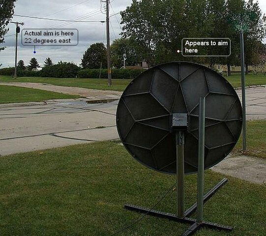

Or - put the dish sideways like I did. Dish face tipped back(from vertical) your required 9.9 degrees = elevation.(mine is 6.4 degrees) Azimuth will be L or R(depending on which way you 'twist' the dish) the offset of the dish. (~22-26 degrees)

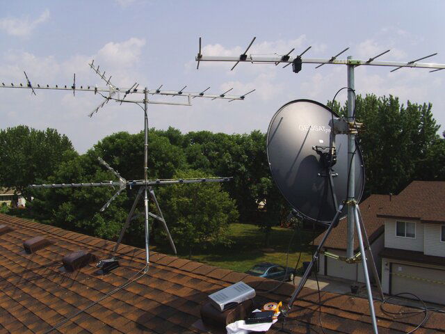

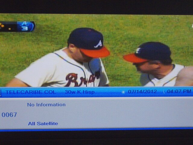

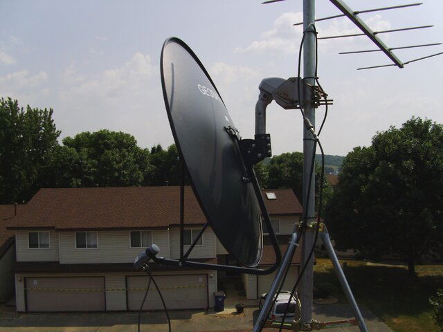

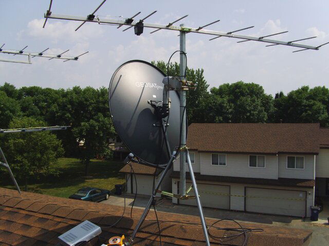

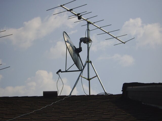

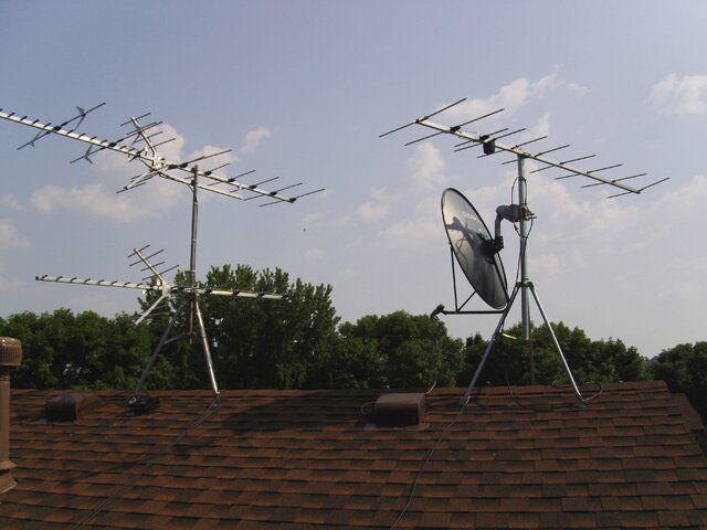

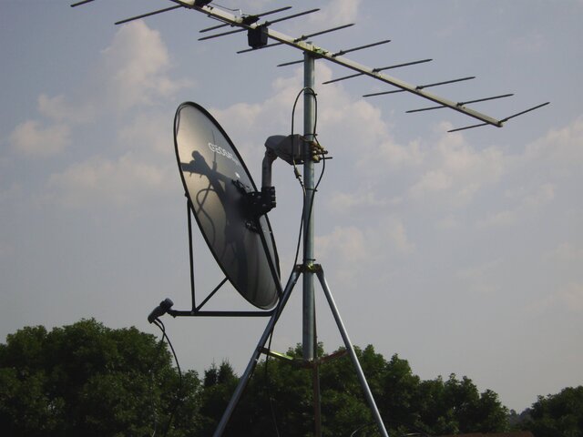

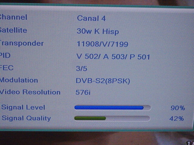

Well that wasn't too bad....but when its 93 out anytime on the roof is tough :) But got 30W with its 9.9 elevation and trees about 175 feet away

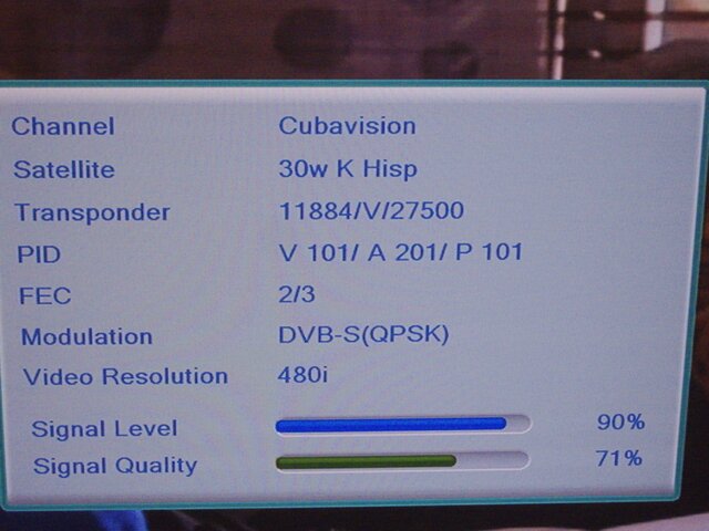

Went up and put the motor up there. Made sure the shaft was points straight down. Took the GeosatPro 90cm dish up and placed it on the shaft. Now the fist issue was the bolt that goes across the elevation "slide scale" is goofed up (holes arent lined up properly) so I couldnt put it through the holes on the motor shaft. So basically I have to tighten the bolts down real good and kinda "bear hug" the motor shaft
Used the trusty Pansat 1500. yeah its old and a pile but damn it sniffs out signals fast and shows a 10 quality if it finds it. So it only took maybe 10 minutes once I was hooked everything up to lock a signal on Cubavision at like 15...Tweaked the signal to lock it at 60 on the Pansat. Tried the other DVB signals and all are between 58-73.
Temporarily hooked up a cable and tried the MicroHD in the house. Got almost everything. There are 2 signals that I cant even get a sniff of. But everything else came in fine
Dish looks like its pointed at the ground :)

I think Iceberg is fooling with us! That dish looks like its pointing at the roof, lol. But, if it can be done, then I have to say he's the one to make it work. What kind of antenna is on top of the pole, FM or vhf-cut for one channel??
The antenna on top is a Winegard YA1713 VHF antenna (7-13). Its aimed SW for the neighboring market (Mankato)...CBS & Fox subchannel (only station in the market on channel 12). Its 72 miles away and signals are usually at 100% at night and mid 80's during the day (really stable)
The other antennas are a HBU44 (top) and HBU33 (bottom) both aimed at Minneapolis
HBU44 is hooked to a 2 way splitter for HDTV and Directv OTA tuner
HBU33 is hooked to a 4 way splitter to bedroom, computer room, basement and neighbor's garage (yup)
The reason I dont use just one antenna is when I have a 6 way split (or a 4 way and 2 2 ways) is the signal on the weaker signals get cut more than 1/2. Plus the HBU44 has easy access to bypass the splitter in case I want to DX OTA and get stuff from further away when its been humid :)
