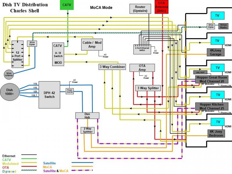

Here is an example of a centralized wiring area. This is very complex but it will give you the idea. You can also get a cabinet to put the wiring into.
Wiring diagram for 2 Hopper 3 and 6 Joey
LOL. So you think my redneck head end board is very complex! :coco It was really complex when I had four HWSs, two Dual Nodes, and two DPP44 switches.

I have four coax (119, 110, 129, & 118.7) from my DISH 1000+ to my DPH42 switch on the head end board. At three TV locations I have four coax (Satellite, OTA, Modulator In, Modulator Out) that go to the head end board. Modulator coax are needed to have the capability to sync recordings and TV to all TVs in my home thru a home distribution splitter.
