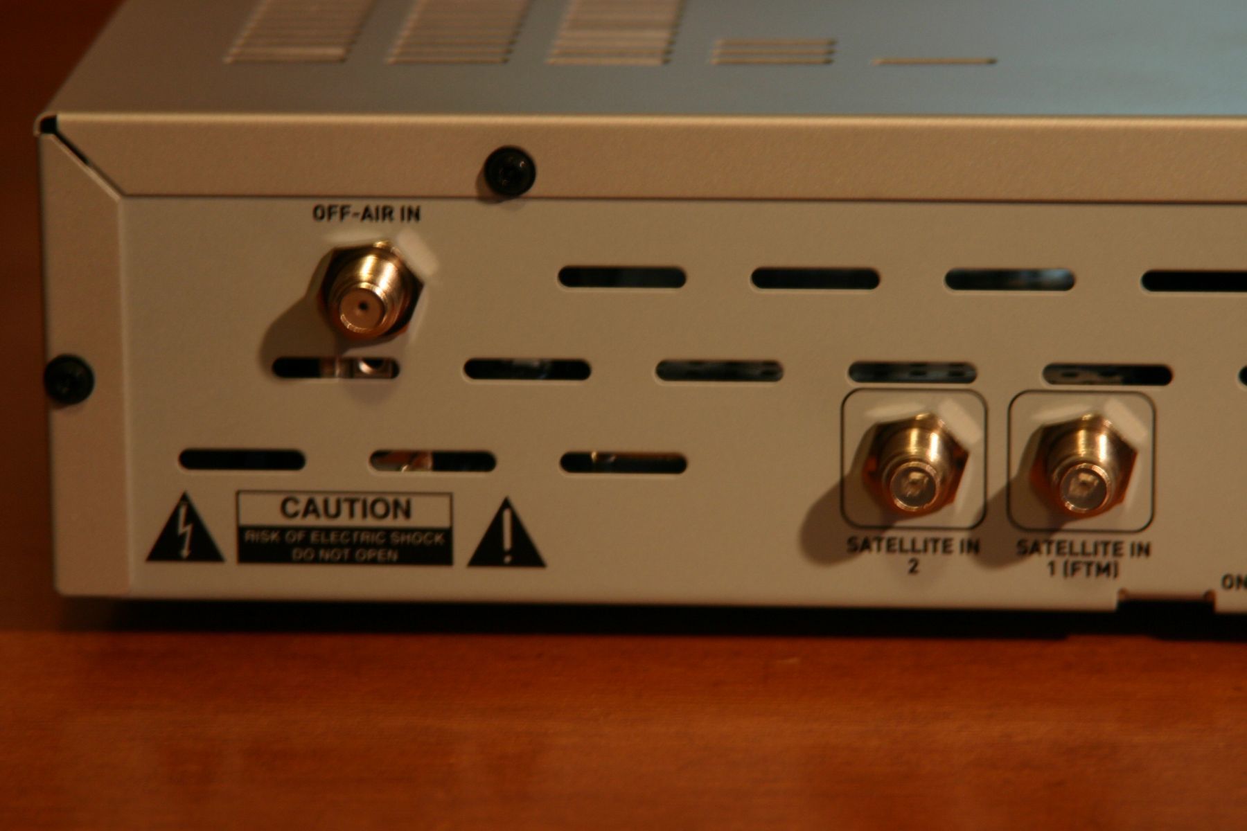

i was wondering if someone knows if the HR20-700 supports the swm lnb? thanks....
Yes it does.
ok. one last question :) why does it say on the -700 FTM instead of SWM? is it the same thing? just want to confirm since i have done very little reading on the 20-700.
Don't forget that the HR20 series was released prior to SWM being released. I did some looking and it looks like FTM was the original name prior to SWM.
thank you jagz!!!! i really appreciate that. i am looking at one of these to purchase. by the way i resized that pic:D. thanks again.
