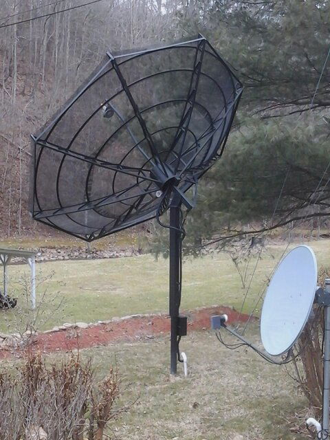

Ok FaT Air now that I have managed to upload some photos to the site which I consider an accomplishment in its self due to the time it took me to figure out just to do that they are here for the viewing. Now I realize the orientation is off but still here they are. In the afternoon when the sun is out, I shall gather more information regarding my system and how it is hooked up. But as you can see in 3 of the 4 photos you can see my smaller ku band dish.

Your approximate location is 36.47,-82.27 so 83W is almost due south. Dish at apex, should be able spin the mount/dish on the pole to tune in the PA channel, freq 3804 Vertical pol, SR 4167
Another thing that may be the problem is skew. May be backwards. Don't know, for sure, but the "0" skew mark may have to be placed at the 3 o'clock position. (Might just program the polarity as H ??)
