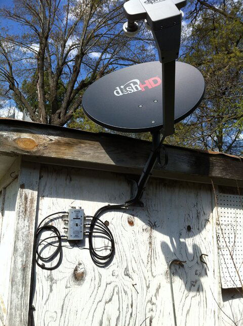

hopefully tomorrow will be better and it gets fully installed. Plus my dual dishes got upgraded to a new 1K.2 dish so that was also nice. looks much better at the dish location on our out building behind the house.IMG_1022.JPG
