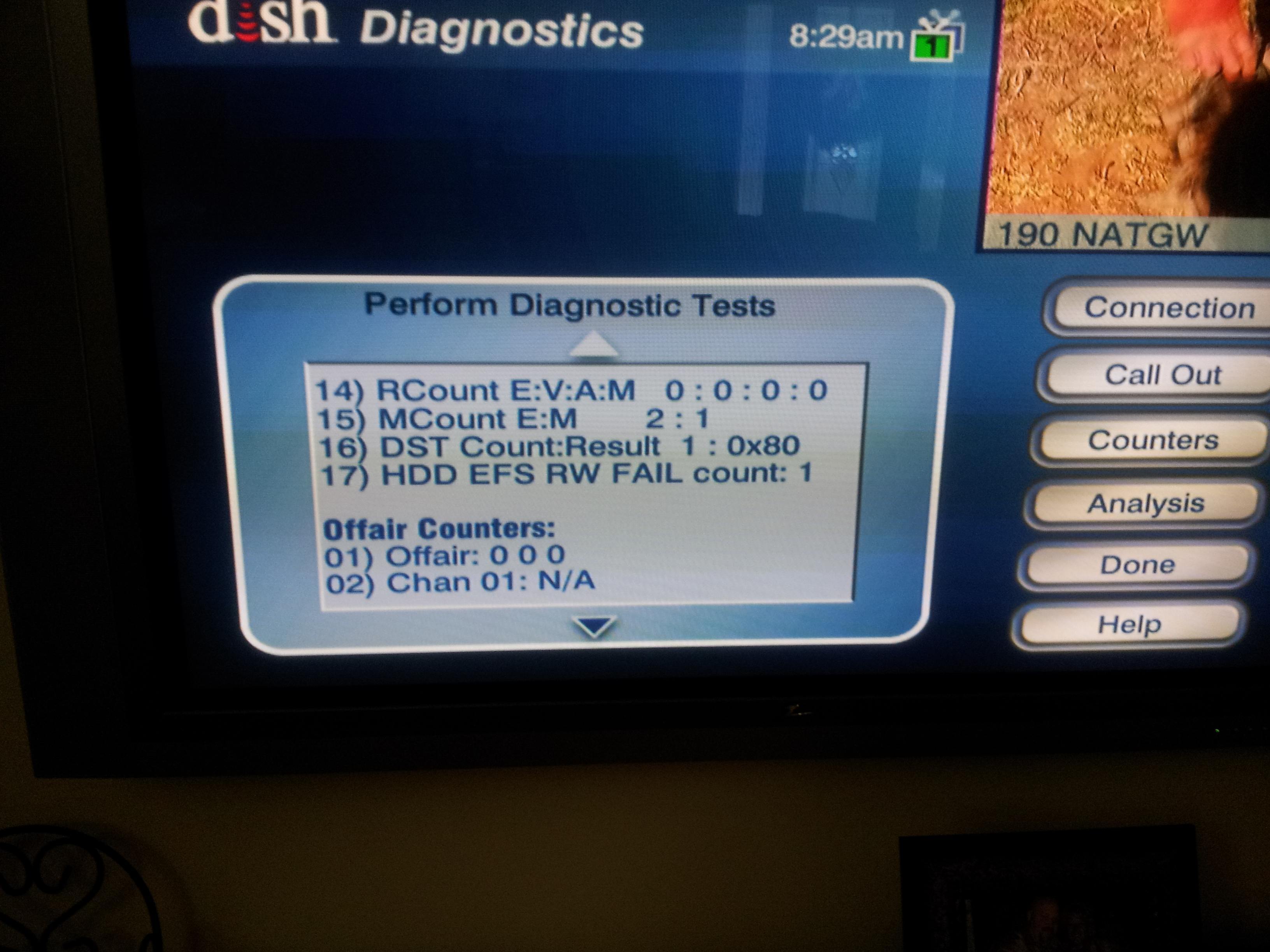

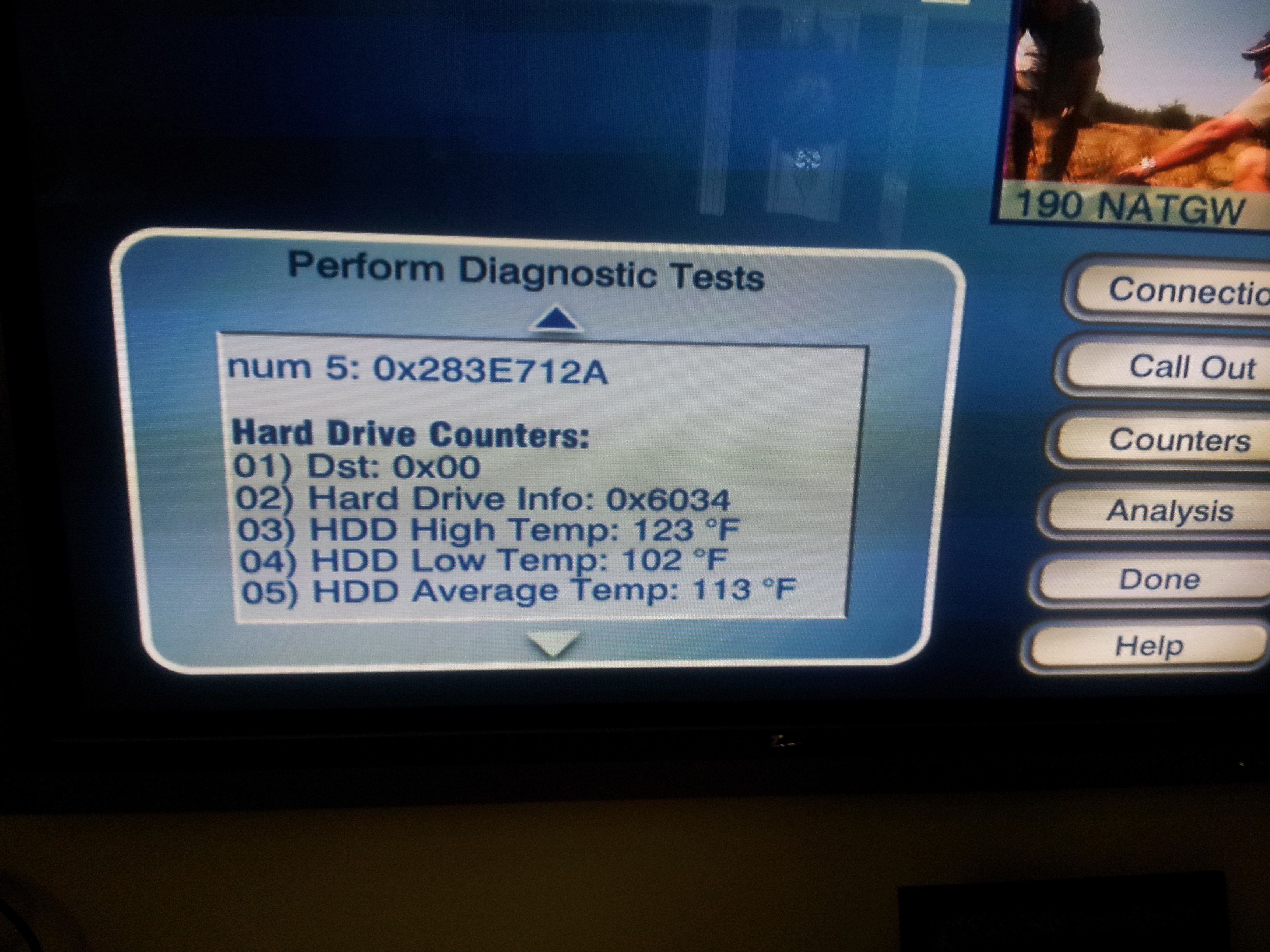

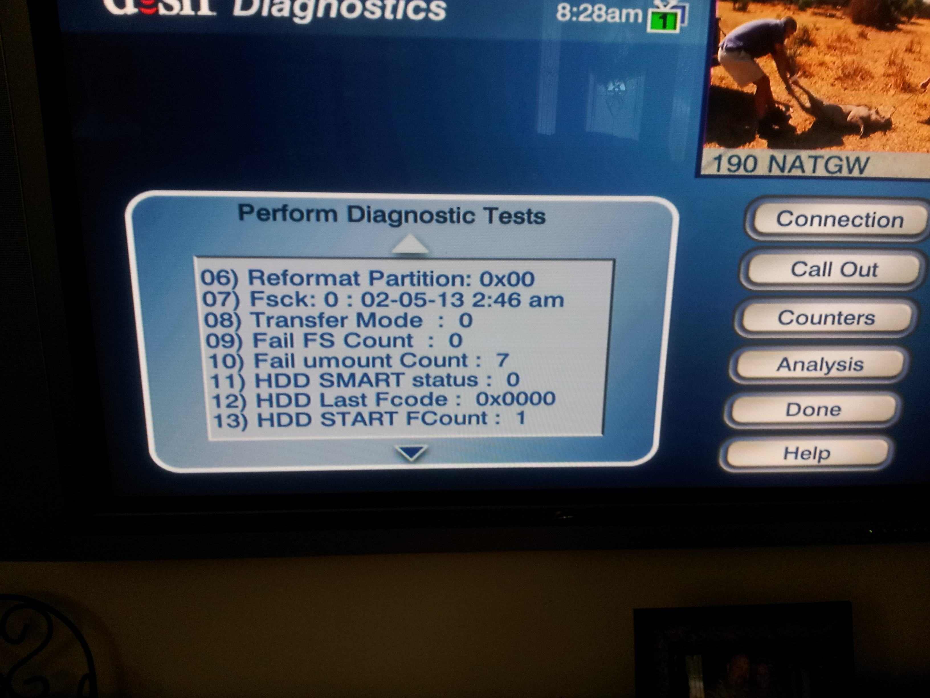

My 722 has been acting up for a couple of months now. I think it's exhibiting signs of hard drive failure, but not 100% sure. It was frozen when I got up this morning, a reboot brought it back. Live and paused TV have been fine over the 2 month period, as has playback of older recordings (from before it started acting up). Newer recordings will stutter and freeze so much as to be basically unwatchable. I've attached pics of the counters listed in the hard drive section of diagnostics. Anybody see anything concerning? I'm guessing the failure count of "1" on the last counter probably isn't good.
Also under "Analysis" the "Hard Drive" button is greyed out and not selectable. Is this supposed to be the case?
TIA for any input.
You might want to look at the date of the latest file system check (fsck) way down the list. Mine recently on 722 had a date in the future--not good. With the monthly check it corrected itself--now where are the diagnostics on Hopper?--found it before. Monthly is in the same menu as fsck (Menu+6+3+Counters+Page downs on 722.) The fsck should be run every day or the recorder will get weird. Three days without one and it barely works.

Thanks KKlare, it appears to be regularly running the fsck. Twice yesterday, around 2:45am and 8:30pm.
The drive was showing "full" in the Recordings "History" so I deleted a bunch of stuff that I hadn't gotten around (and probably wouldn't have) to watching. We'll see if that does anything for it.
