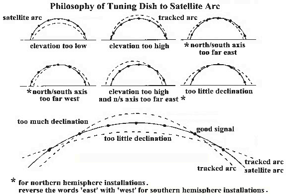

One question that's been lingering: How do you know if your motor's arc is shooting too high or too low?
I would say start with the first satellite that has channels that are degrading/weak. Take the tv out to the dish where you can get 'instant feedback'. On a weak channel, push down on the bottom of the dish, see if that helps or hurts, then pull up slightly on the bottom of the dish to check any effect. That should tell you which is the problem.
Firstly though, check the pole for plumb, and make sure the motor bracket is level on the pole. SO many things can upset the tracking of a dish. And for the moving dish motor-I can sympathize. I have one receiver that will start moving the dish on its own if I happen to hit a vacant channel on a satellite. And it will TELL ME, lol, the Motor Moving screen comes up and nothing I can do will stop it, short of rebooting the box! if yours is doing that, it may be the reciever rather than the motor.
This diagram may help:
If both *ends* are off, rather than azimuth/needing to go east or west a bit
See Tron's post above re: Declination angle
