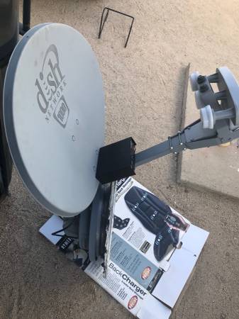

There is for sale in my area. I am a total neophite when it comes to this stuff.
All Dish Trav'lers I see have a Black dish with. I called Winegard and they said the same. This is advertised as a Sk1000 but the dish does not match the pics of a Winegard.
Can anyone identify this set up from this pic. I am trying to see if this will work on my rig for a Hopper 3 set up using the DHP connectors. Thanks for any help as much of this is new to me.

Trav'ler SK-1000, the Dish version have come with Gray and Black reflectors. $1600 for a Trav'ler, too high.
A SK-1000 will work with a Hopper 3 by using a Dish DPH42 switch between the Trav'ler and the Solo Hub.
