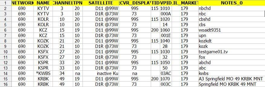

I've got a spreadsheet that was at "the other site" and it shows that info. I attached the pertinent info for Springfield. They use to be on 73W which requires a 2nd 18" dish but Directv has been moving folks who have a setup (2 separate dishes) for a year or so now (they are vacating that satellite) and giving them the setup like your mom has (slimline and HD receivers)
