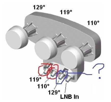

I have one hopper and 2 joeys I got a 1000.2W the lnb of the 1000.2W has 3 outputs but the solo node only has 2 inputs
so I connected a cable to ouput 1 and 2 to solo node, did the trick with foil and just aiming 119 with the middle lnb I got 75%
after i took out the foil I saw that 110 was detected but really low 35% and still nothing on 129W, am I doing something wrong, do the 3 cables have to come out from the lnb since it has 4 outputs?
The dish is made to use with more than one type of Dish receiver. With one Hopper, you only need two lines from the dish, you would need another line if you get a 2nd Hopper. Either the arm that holds the dish is not plumb or your skew is off. You should not that the numbers are not a percentage, but you still want high numbers, 75 is very good and 35 will give you problems especially if you have a clear sky with no clouds.

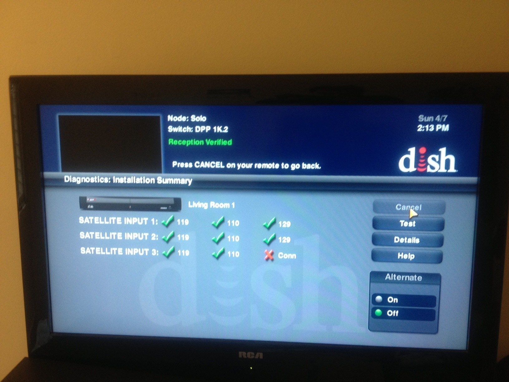

That screen you posted makes me cringe, I've seen that on a bad hopper and a bad node, the first 2 tuners seem to have pulled some information of the 129 but the 3rd isn't.

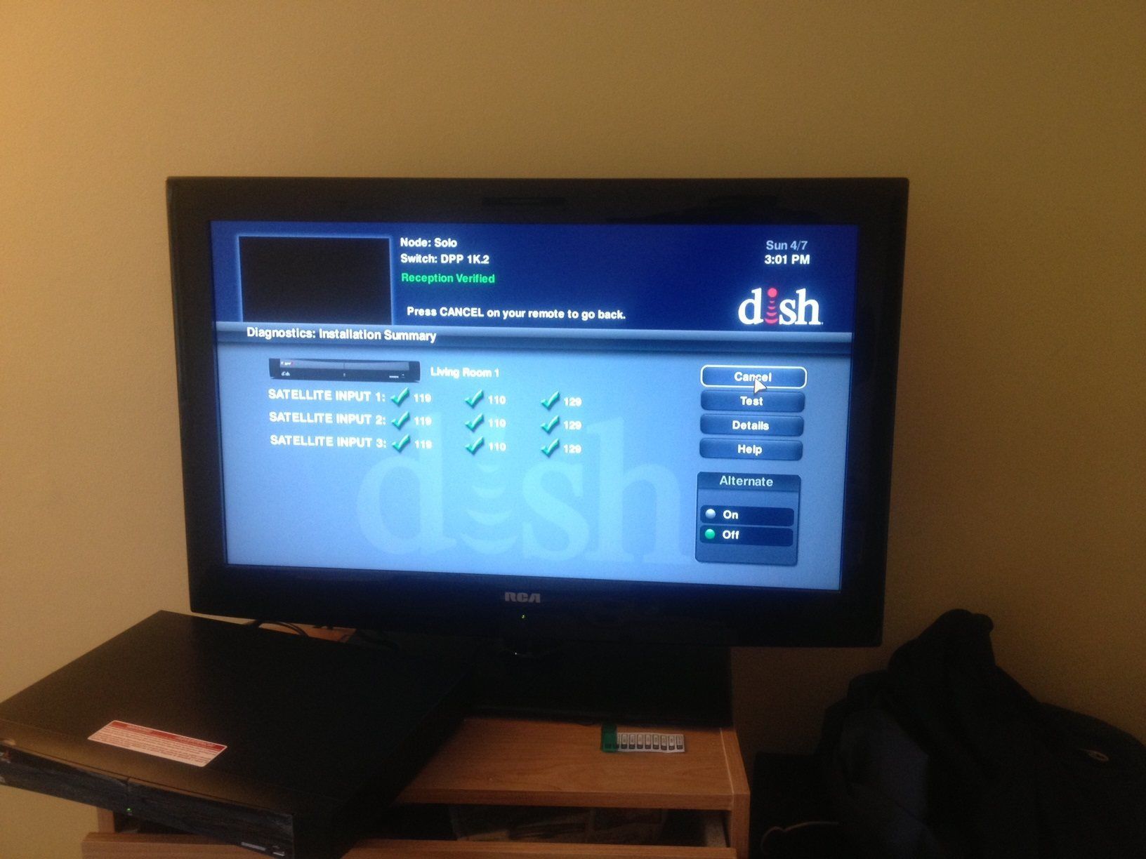

I did some tweaks and I got 129 to show up
but when I click on a HD channel I get signal loss so I guess I have to tweak some more
I got 110W up to 65% aswell but still no 129W
You may need to get an EA LNB for up there. Not sure about Buffalo, but I know the Rochester, NY HD locals are on EA only as 129 doesn't come in very well due to how low in the horizon it sits.
