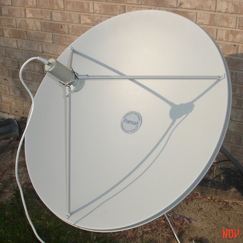

I found this Dish for Sale on Craigslist, $30.
It's a 36" Prime Focus Ku Dish from Pansat, light commercial I'd guess

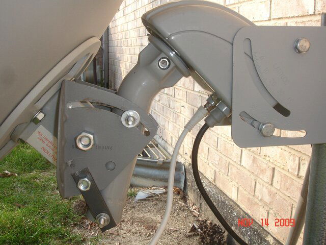

The Goal was not to spend any more than I had, and use "parts" from around the house, and not destroy the original Mount.
Motor is an SG2000 that was driving an 80cm Fortec.
Mounting bracket from an old DirecTV Dish

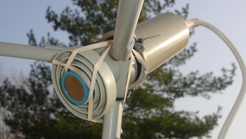

Scalar came with Dish, but the Feed was for a "traditional" Single Polarity Ku LNB, like one used with a CoRotor Feed.

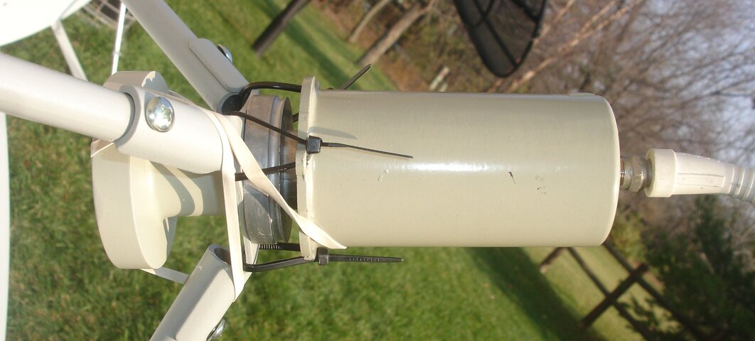

For an LNB, I used the Ku end from a BSC621.
And it works! :)
Good work-how's it work?
And I like that "goal was not to destroy something" lol. That's always my goal, but I usually tear whatever it is up anyway.
Looks good. With all the different components I'd almost call it Franken-dish, but that might imply it's ugly, which it isn't. I like the rubber bands on the lnbf, whatever works is usually my motto! :up
Yes, I think you are one of the first to report good reception with that end of the BSC-621. - :rolleyes:
