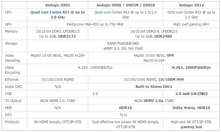

I've been pondering on a KIII PRO DVB-S2 DVB-T/T2 by AceMax.
Amlogic S912 OCTA Core 64Bit DDR3 RAM 3GB RAM 16G ROM
BUT it still only lists 8psk! (And $142...ouch)
That could be a sweet android box with a 16psk capable dvb-2 tuner in it. (Or is that a chipset limitation? IDK)
Anyone know of a lower cost source...maybe without the DVB-T tuner?
I've researched android and linux boxes until I'm more confused than when I started. :confused:
There is currently no LibreELEC support for S912 devices. There is a long thread on LibreELEC forum discussing the topic.
