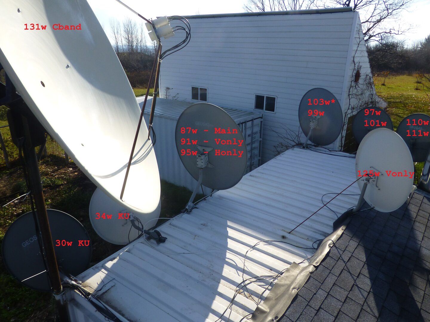

Hey there.. Good luck in your project... I see there is already a link to one of my threads, but i think i can more directly talk about the switching. I am lucky as that i have not noticed loosing a signal between tapping directly at the dish, and inline through all the switching. I did have a scenario just recently where i couldn't get some signals on 34.5w. But, it turned out to be a poor performance LNBF. I swapped out the LNBF and that solved that issue. There are a couple of FEED channels i cannot get on 91w, but i cannot get them at the dish either, so it has nothing to do with the switching. It has more to do with i am using a side-car lnbf to pick up 99w and I am probably not 100% fine tuned on it.
I cover 30, 34.5, 87, 91, 95, 97, 99, 101,103,110,111,113,117,121 . I utilize multiple dishes, and multiple LNBF's on the dishes. I added additional complexity in that i wanted it to work with 4 satellite receivers at the same time. So, i utilize diseqc 1.0 , diseqc 1.1 switches and then a bunch of Eagle Aspen 5x4 Satellite Multiswitch S-4140-GX 54-2150 Mhz . This allows me to hook up 4 satellite receivers to every dual LNBF. I have my diseqc 1.0 switch at the receiver, then that goes to multiple destinations. Up-line to those each one also has a diseqc 1.1 switch that then branches off to the different 5x4 switches. Each 5x4 switch allows 2 horizontal and 2 vertical lines to allow for 2 different satellites, or even more if you want to restrict one or more LNBFS to only vertical or horizontal... Example : I utilized 125w VERTICAL ONLY and 95w HORIZONTAL only so I was able cheat and get additional sources with less hardware. The 5x4 switch uses 22khz to switch between the two different satellites it handles.
I also created a favorites list that contains the switch destinations within the service name. I found this to make it easier to trouble shoot and more quickly track down where in-line i might have potential problems. The first number represents Diseqc 1.0 port , the second number represents the port # of the diseqc 1.1 switch, and the ON/OFF represents the 22khz tone. Port 3 of my Diseqc 1.0 switch all goes to one storage container. Port #2 goes to 8x4 switches i have in the basement to cover my two additional cband dishes at the house, and then Port #3 goes to another storage container that hits another farm of KU and Cband dishes. Port #4 is utilized to tap into a DVBS modulator that converts my Digicipher signals to DVBS signals that i can then gain access to through port 4 on all my satellite receivers. I then used a secondary TUNER for my once USALS KU.
Here is a picture that shows many of my KU dishes. I have another farm of dishes on another storage container not shown in the below picture.
