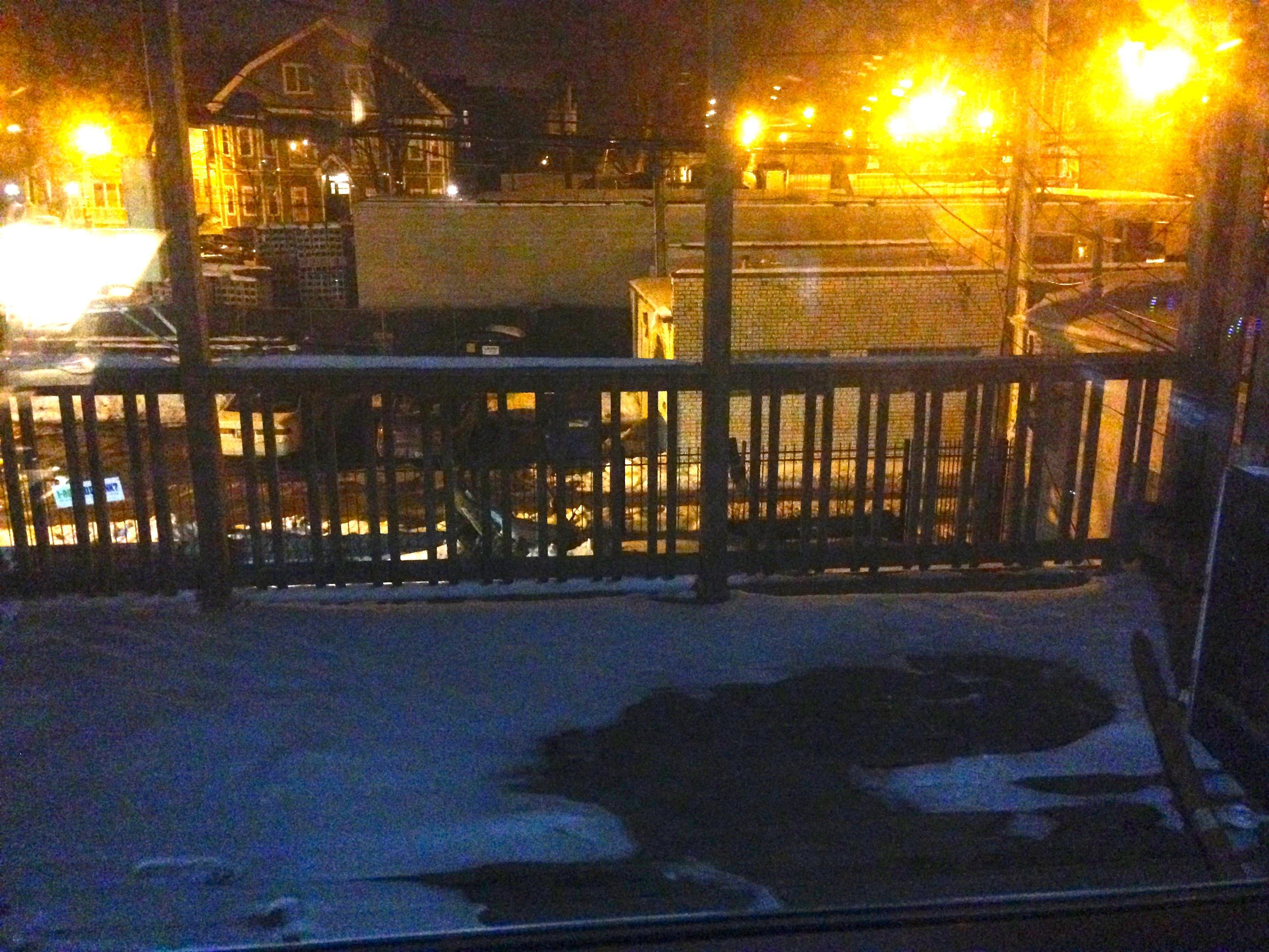

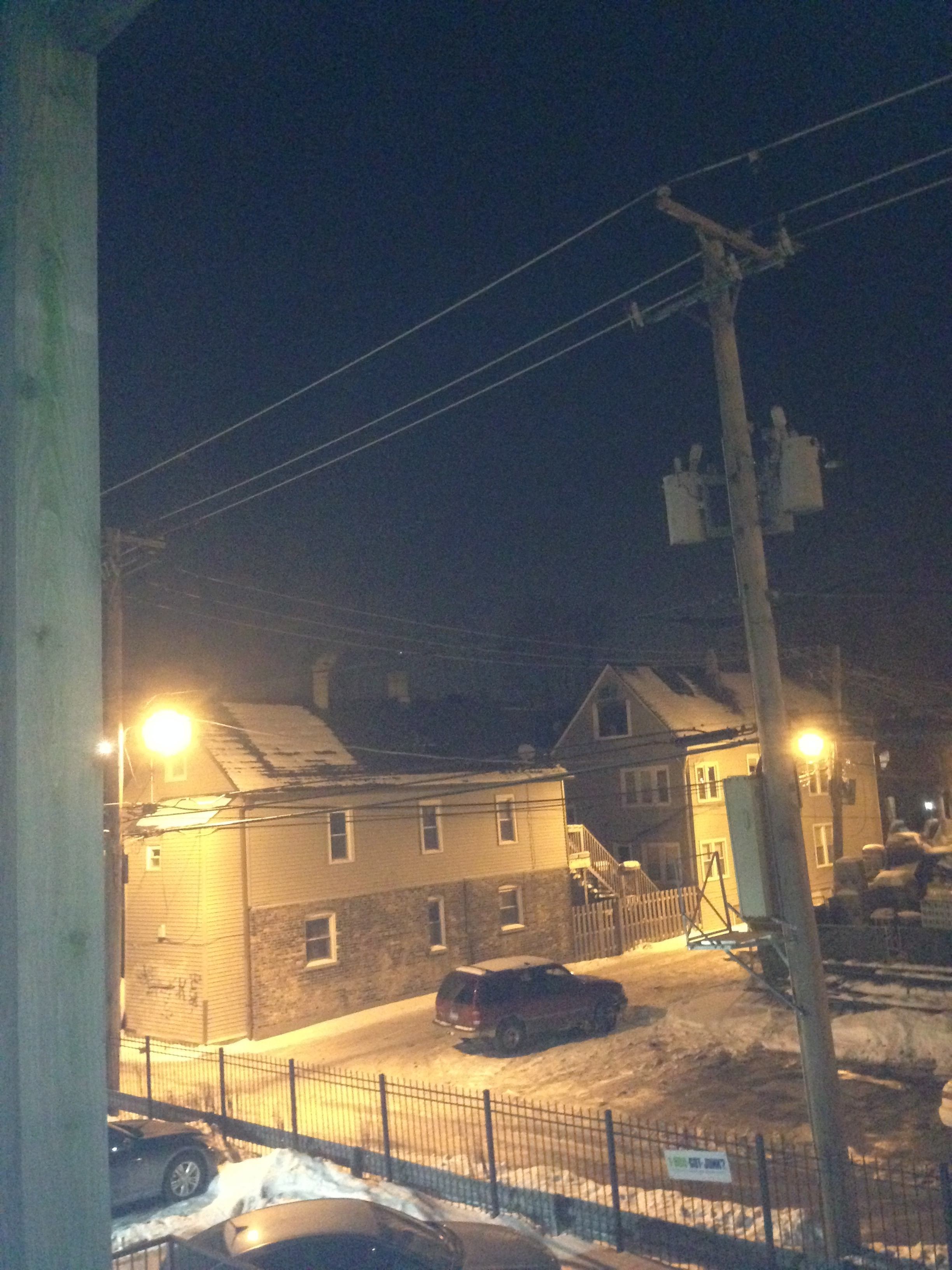

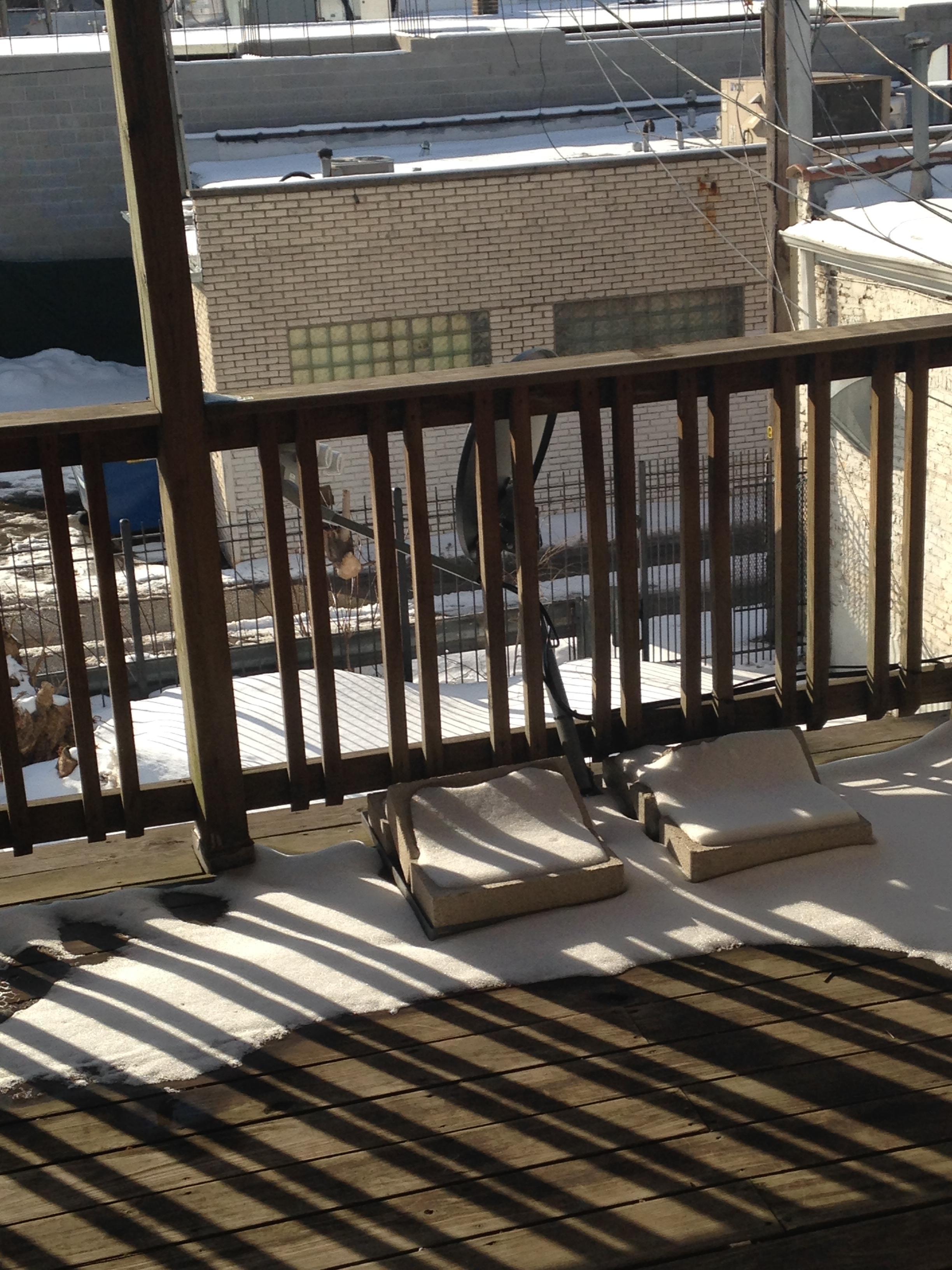

I am thinking of getting Directv as I am unhappy with my Uverse HD quality. I have had non pen mounts before on the roof, but my landlord wants it only on my porch. I will include pictures so you can see the porch and the railing. My only problem is I think the banister will get in the way of the signal. Can anyone take a look and see if its possible to get this done. I asked about attaching it to the porch or banister and that's a no go. I am in Chicago with zip code 60613 and looking to get the genie.
Any help or ideas would be appreciated!
First photo is where the dish will be, the stuff you see will be moved. Please note the banister. Second Pic is the southwest view.
Third pic is to give you an idea of the size. Sorry it was dark I had to lighten the image.
It's hard to tell with pictures, but it sure looks like you have enough room for a non penetrating mount. If you have a smartphone, download the AR Satellite app. It will give you a good idea where the satellites are.
satbeams and dishpointer will for the locations of Directv sats. You have a lot of space to work with more than I do plus your railing is about 3' from the floor you should have a enough room to work with.

In cases where there wasn't enough clearance from a patio/balcony from a standard non pen mount where say the rooftop was in the way to extend the height of a dish I have used a balcony mount pole instead of the center pole that normally comes with the non pen. It just involves drilling holes in the mast for the bolts to match the holes in the mast that comes with it but works great.

Width of the balcony? Height of the railing? Distance between top of the railing and the roof over the balcony?

go to this site....http://www.dishpointer.com/....Key in your address with zip code.
Then, on the right side of the image, you'll see an ad for a free dish pointing app. Download it. Crouch down so your eye level is roughly three to 3.5 feet from the floor of the balcony. The phone app will show line of sight.
Oh, this is not exact. One thing is most of the signal hits the top 1/3rd of the antenna. With the dish pointing at almost 40* of elevation the roof over your balcony is a concern.

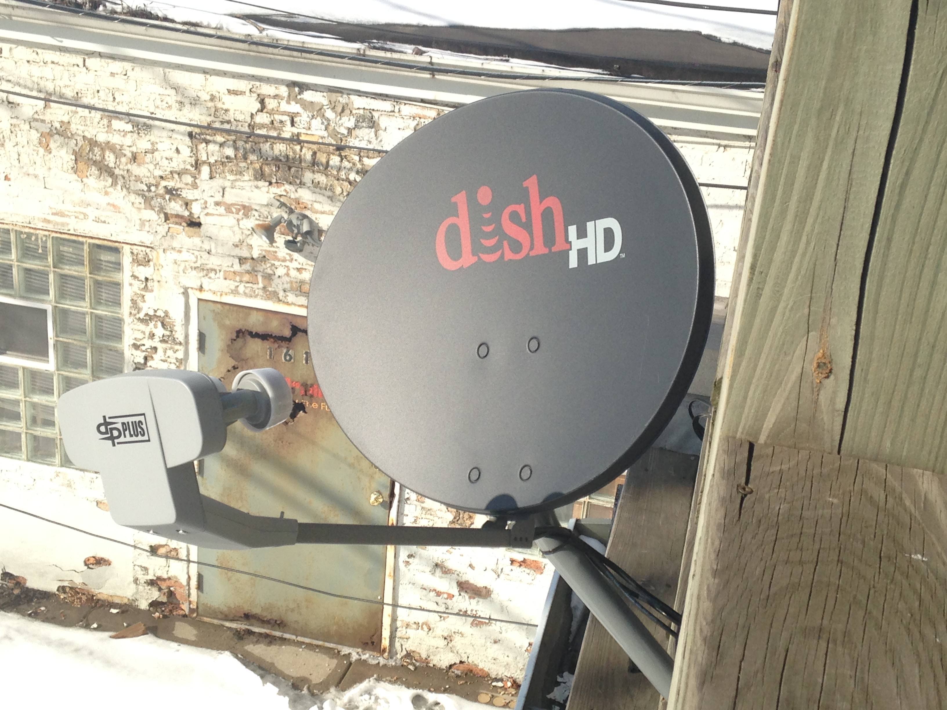

Thank you all for your help, due to the direction I was not able to go with DTV but I was successful with Dish, a bit sad as I wanted the real good HD from DTV. But hey its a slight bit better than Uverse.
