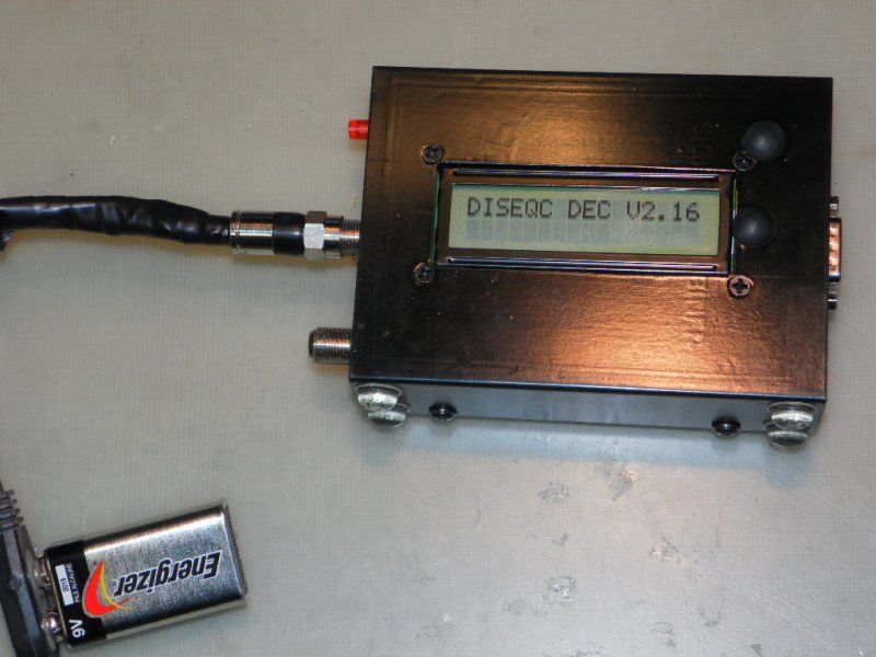

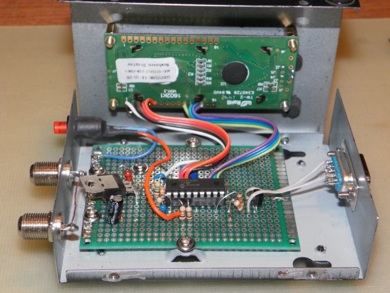

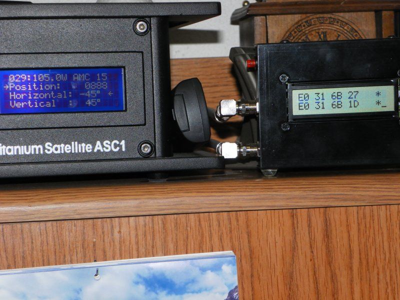

But if you have some soldering skills and a real desire to see the DiSEqC calls pass thru yourself there is a DiSEqC decoder you can build. The schematic was provided by another member here. N0QBH Free to Air Satellite PIC Projects
I have built this and watched my ASC1 perform. :)
I wouldn't expect any issue as long as your receiver outputs the protocol standard level of approx. 600mV and the switches aren't located hundred of feet away. :)
As Magic Static correctly commented, the 22KHz/DiSEqC is a only a pass-through circuit. Like with any loop-through device, there won't be any problems as long as the control signal amplitude is adequate for the down stream devices. Each series (cascade) of switches attenuates the control signal. With any system, multiple switches in series can create a problems with increased attenuation.
From experience, the DiSEqC decoder is a very useful test device and I use it often on the bench. Thanks Magic Static!
