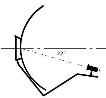

Isn't the distance of the LNB from the dish determined by where it hits the center of the dish and the target angle (22 deg.)?
I may be off base here but if this is the optium placement, moving the lnb forward would have it aimed too low on the dish. I would think that would lower the signal Q.
How important is it to maintain the proper target angle and hitting the dish at its center?
Typically, the LNBF is not aimed at the center of an offset reflector.

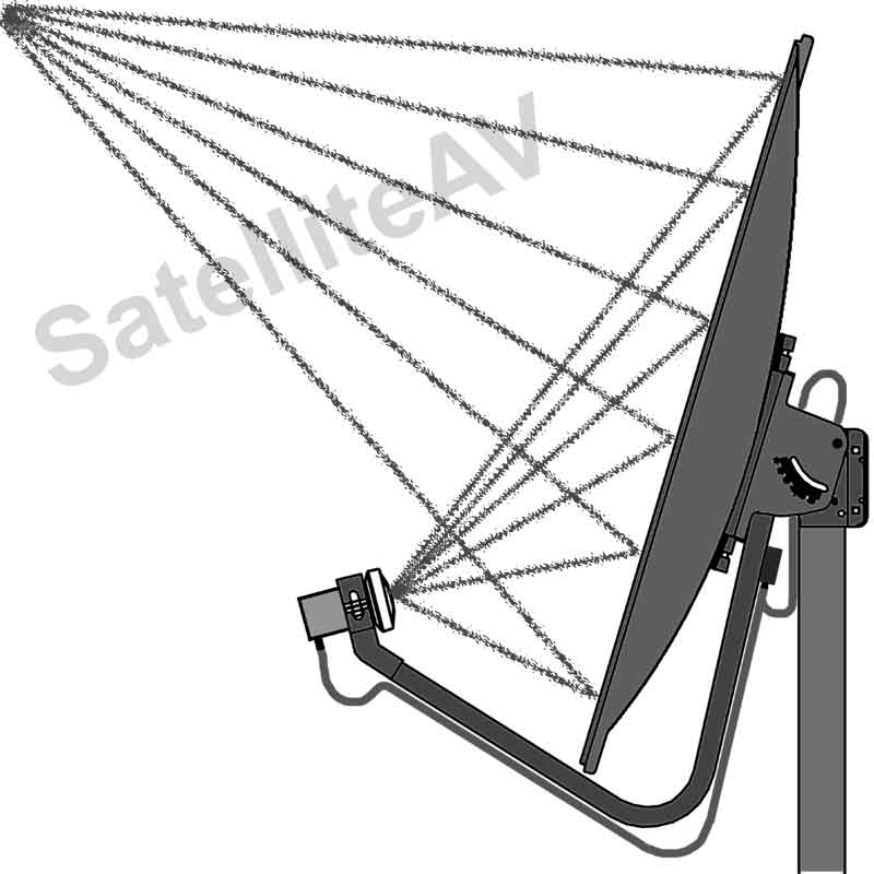

The sweet spot for the feedhorn placement is the point of convergence of the reflected signals for the desired satellite.
