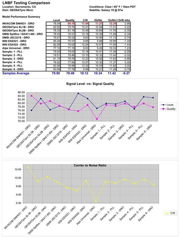

We have received several batches of KU-Band LNBF samples from manufacturers to evaluate for our next generation LNBF. Decided to compare these candidates with some of the more available LNBFs currently sold in North America and the Alps Universal that I picked up in France last year. Enjoy these 5 pages of results and the final summary comparison page. I remain amazed at how a 7 year old Invacom SNH-031 continues to be the best overall performer year to year running....... Speaks volumes to the quality of build. :D

In reviewing the results I found it is strange that the JSC321s and Spitfire performed much better in a test last May. The only difference with in the testing procedure was a slight temperature increase and the dish aiming was optimized on 11842 where in the last round the aiming was optimized on 12177. I found the ESX522 to provide good overal results, but the ESX521 had an overall lackluster performance. I was also reminded that the highly rated European LNBF, the Alps was easily the worst in any performance test!

We are developing sample #5 - PLL for our next product offering. Typical solid PLL performance with rock solid LO. Seeing if we can pull down the current requirements, but overall very impressed with the performance and especially the flat response throughout the band! Looks like Satellite AV will be offering the world's first Standard LO PLL LNBF! Excellent phase separation and low heat generation.
No BS marketing lies about being able to provide a 0.1dB NR.... NOT POSSIBLE!!! This will be a 0.5dB NR typical with 60dB gain. No need to lie and overstate the gain and lower the NR. PLLs are higher NR and lower gain. PERIOD.
Sample #4 was the only two output PLL that we received. We had not requested any two output samples as we were initially concentrating on the single port, but they threw this sample in. We are quite happy with the extraordinary stability , gain, phase and noise figures on the GEOSATpro SL2b and hadn't given much thought to offering a PLL version. The chipset for sample #5 could be integrated into a dual output design. We will need to investigate the potential market as development cost can be quite high on these custom North American Standard LO builds.
