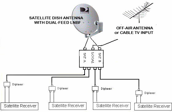

Yes, you should run both (the 2) outs from the dish's LNB directly to the multi-switch. Then use the outs on the multi-switch to feed ALL of your receivers. Do you have the make & model of that RS switch? or do you know what format it is? ex: 2x4, 3x4, etc?
Maybe THIS ONE
If guessing yours is similar, see the attached diagram. If you do not have an added OTA antenna, just ignore that and the dixplers at each receiver.
that is the switch i have. i have one cable running into the one input and two cables coming from the receiver 1 and 2 to the dvr. i'm working right now so i will try hooking up both cables from the dish to the multi switch tomorrow morning and see if that works.
will it make a difference if i hook the cable i have going to the switch now to the other input and switch the outs to the dvr to that one???
