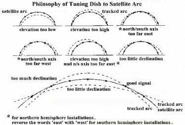

A cheap tone signal meter is desired at this time. You can hear that tone get louder, better than what shows from your receiver. You should go to several satellites on the arc and push on the dish to see which way the dish should be adjusted (without adjusting). Then look at the attached photo and determine your situation. Then adjust appropriately. I spent 8 hours (four hours wasted due to mixing up the declination angle) and finally got the BUD on the arc. It is amazing what satellites show up once you are on the arc.

I dont have an issue getting the arc, just low signals. I can get from 72 to 125. Anything lower then 72 I have no interest in
