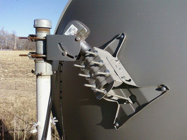

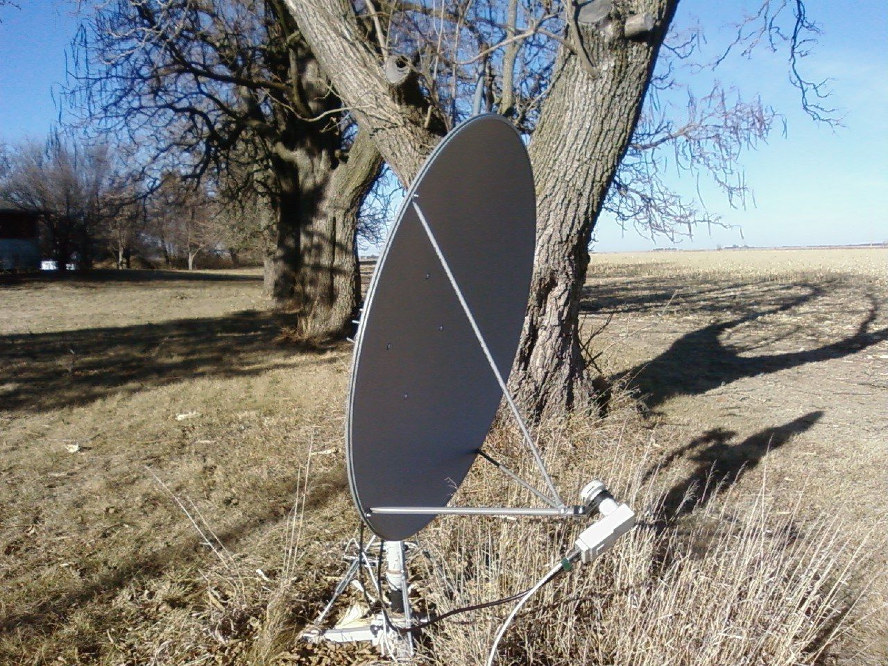

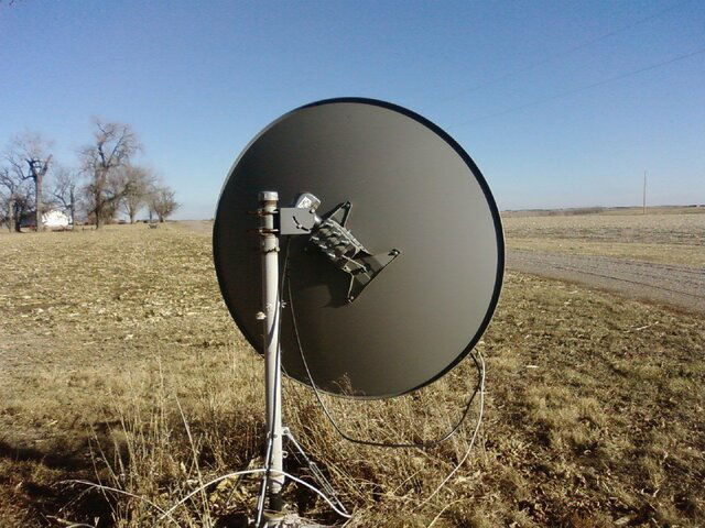

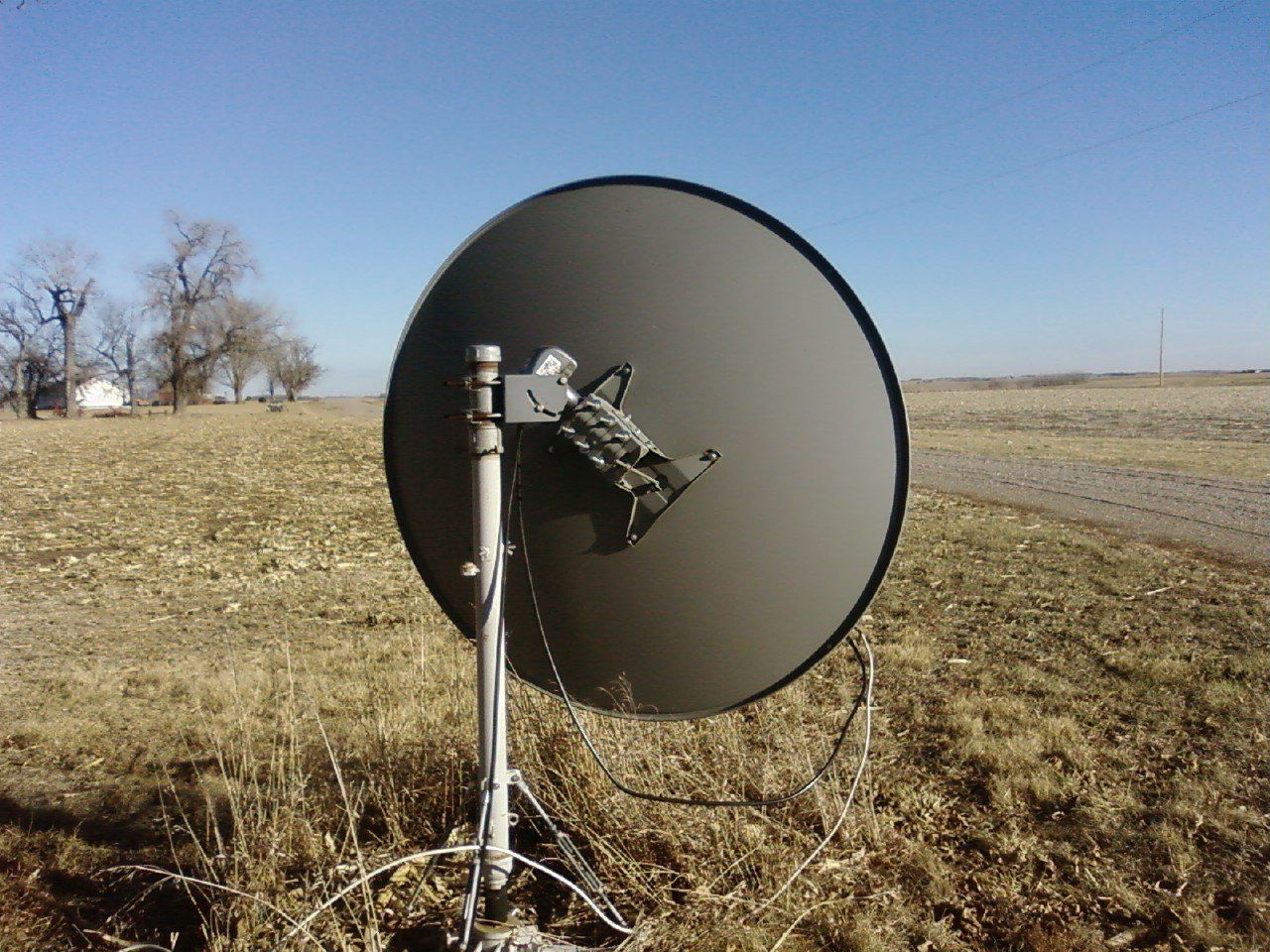

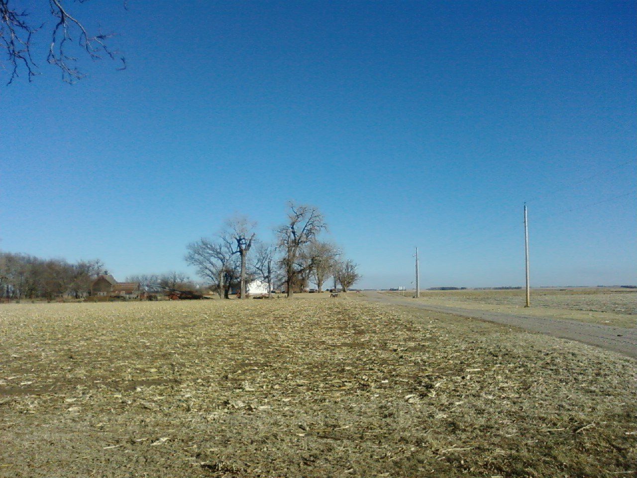

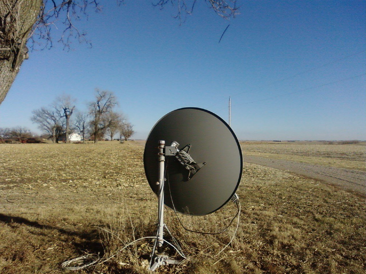

I received my new replacement USB adapter for my cellular phone micro storage memory chip today. Now I can retrieve my photos. Here are some pix of the dish parked at 30°W, Hispasat (from 96.4°W longitude).
RADAR
Over here at 79.3 even with 30W sat higher in the sky with lots of bumps and trees no hope at all in pointing that far east. I think you lucked out with flat land and no trees.Then again... you get tornadoes.
lt looks like your view east is completely unobstructed. My longitude is 81.6W, and I can get 15W fine... that's the equivalent of you being at 96.4W and receiving 30W. When I point my dish at 15W, it looks just like the pics you posted.
I like it. Has it been reliable for you motoring over that far east?
Toucan-man,
Thank you. Yes, the signal is strong and the channels pop in everytime like a snap! I usually watch Cubavision on TP 11884 V (signal quality is currently showing 80% on my AZBox).

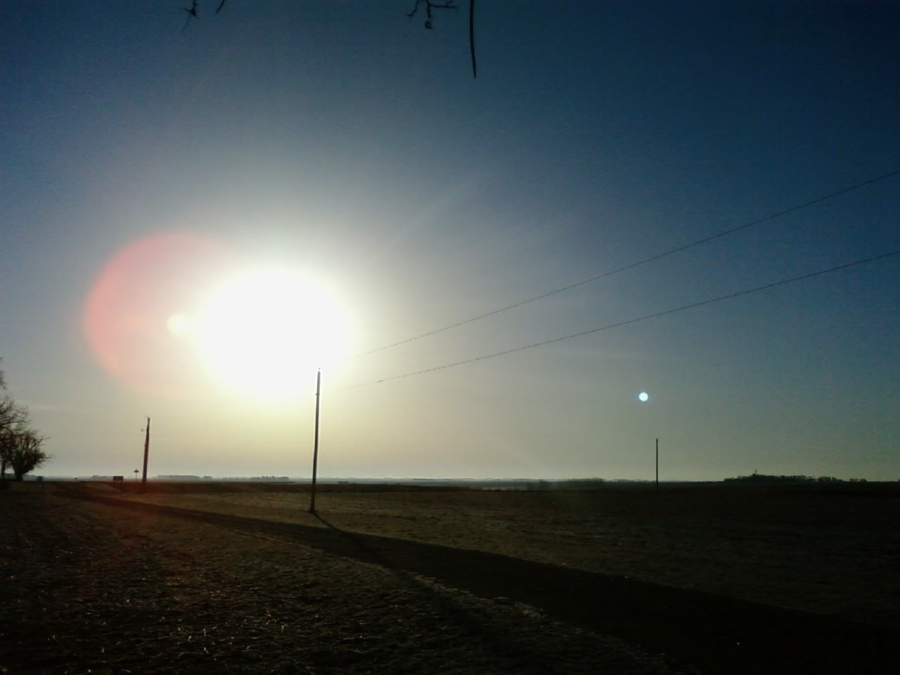

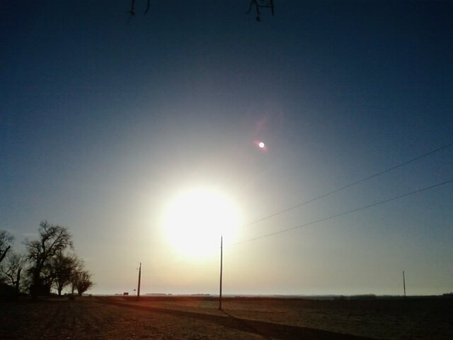

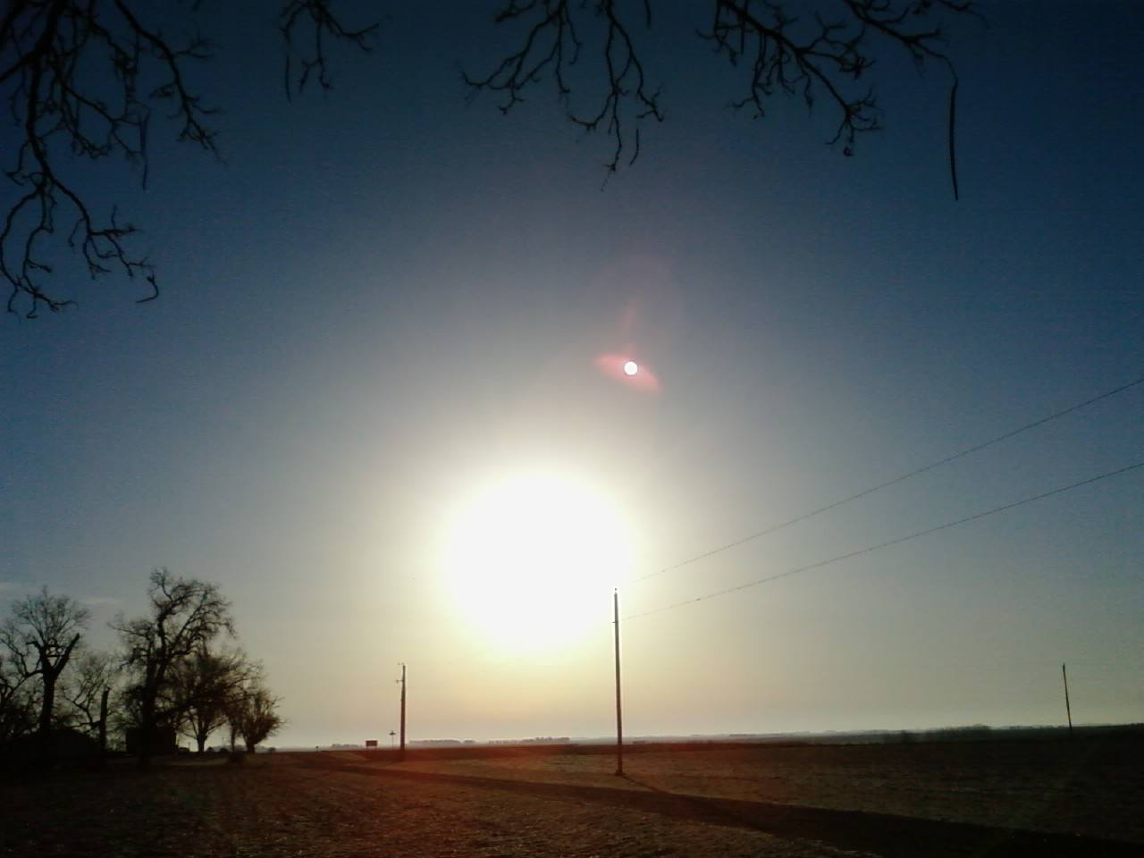

Hello again folks,
Well, I missed the perfect day by +1, but got the perfect time, weather and opportunity. Biggest problem is taking a picture of the sun with a digital cell phone camera w/o any photographic expertise. Never-the-less, I managed to snap off a few pictures that will give you an idea of where Hispasat 30.0°W is on my horizon (from 41.6°N, 96.4°W). It is not very high, but it is a lot higher than I bet some of you imagined.
When viewing the photo, you will have to attempt to pinpoint near the center of the HUGE disc of the sun (which is overly enlarged in the picture because of no filtration or a proper lens). I was hoping for an overcast morning with the kind of haze that allows you to just make out the outline of the sun, but it was a crystal clear sky and that created the effect of depicting our sun as a "Yellow Super Giant".
The elevation of the sat is where I recalled it to be, but its longitude is further south and less to the east than I thought it was. I thought it was closer to the trees to the left in the picture.
I am glad that the power poles showed up well in the photo, that gives a good reference for height.
One picture was taken standing on the left side of the dish, one standing in front of the center of the dish, one from the right side and one from the center, rear of the dish looking over the top of the dish itself. You can tell which one is which by looking at the subtleties in the landscape markers. If you angle your monitor screen extremely (like a laptop display) you can really get a better perception of the foreground elements or the skyward elements.
RADAR
