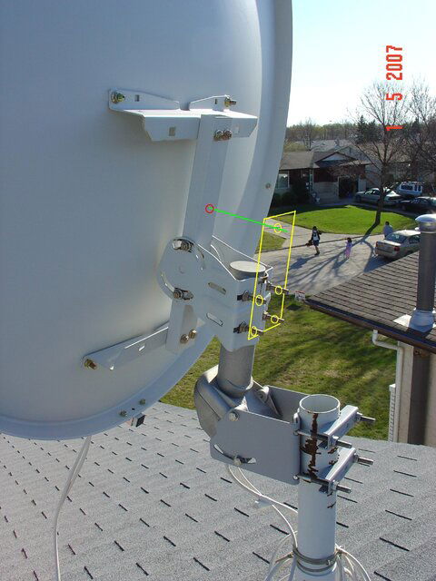

Anole, here are some pics of the present setup. Could a Turnbuckle, a bracket, and screws do the trick.
Sorry about that, but the pics didn't come thru so trying again. Any replies on fine tuning this setup would be appreciated.

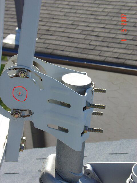

One thing that makes this type of dish hard to adjust is the lack of a pivot bolt. I would think about drilling a hole through the vertical rectangular tube to line up with the adjustment bracket. See picture. Then installing a snug fitting pivot bolt.
One would need to have very good alignment with the existing hole, so would need to carefully center a pilot hole. If you had a center find center punch it would help.
From looking at your 6th or last picture, mount a piece of metal to extend up to the height of the upper dish cross brace from where the bracket mounts on the motor shaft. (or entend the motor shaft) Then a threaded rod from the cross brce to the new piece that extends up. With the threaded rod, you can fine tune the dish. You will need the pivot point as wescopc points out for your dish turns on a precise point. The two bolt pivot point without the bolt in the centre to pivot on makes the dish move around too much when adjusting the dish.
Oh, crap!
That thing wescopc circled in red is not a pivot pin/bolt?
I don't have that dish, and assumed from the pix it was!
No wonder it's so hard to adjust.
Think I'd put a little steel pin through there, and peen it over on both sides.
Wouldn't have to be larger than 1/8" inch, though bigger is fine.
Might find a bolt at a big hardware store, that's unthreaded near the head, to act as a shaft.
Stick some washers and a nyloc nut on it...?

Guys, thanks for all the terrific - great suggestions!
New Pivot Bolt OR Add a 14 inch Plate and TurnBuckle?
Yes, a Pivot Point - adding a new Pivot bolt may be the best way to go! I had discussed this today with my friend who is very handy on lots of repairs, and we had thought about bill190's (Turnbuckle bill's) suggestion of adding in a Turnbuckle. That is: drill 4 holes and attach a 14 inch metal plate over the existing 4 Motor Screws. Then at the top of the Vertical Bar on the Dish, undo one of the 2 screws and add in a small TurnBuckle between the New Plate and the Vertical Dish Bar. Went up and measured it tonight using a piece of cardboard as a template, BUT there was only about 3.5 inches clearance between the vertical Fortec Dish Bar - and the cardboard plate, so it would need to be a very small TurnBuckle after attaching a permanent (metal) plate. Do they make Turnbuckles that small??
But as mentioned the main problem with this dish is too much slop, or no possible fine tuning due to the weight of the Fortec Dish. Once you loosen off those 2 existing alignment bolts, its next to impossible to ultra fine tune this approx 30 pound Dish. It even seems to move a bit while in the process of tightening down the 2 Elevation Bolts. This is why adding in the Middle Pivot Point Bolt may be the best solution. So the idea here is that this new Pivot Bolt would give me more flexibility to adjust (fine tune) the Dish?? Wonder if it can be done while up on the Roof with a 1/2 inch power drill, and then insert new Pivot Bolt nuts and washers ??
in an ideal world . . .
I would prefer to do it on a drill press.
That would require removal and disassembly of the antenna, and much of the mount.
If your friend is a very good mechanical guy, I'd go with his gut-feel.
However, if he's not, do it once the right way, and you'll be happy.
Alignment of the holes is a bit more delicate than I'd want to do by hand, up on a roof.
As to the length of the plate and turnbuckle, don't make the plate so long.
And do allow the turnbuckle to be installed at an angle between the square dish support tube and the plate.
That gives more access to, and length for the turnbuckle.
ALTERNATELY, poke a square hole through that square-tube upright.
Install a long carriage bolt with the rounded head between the tube and the back of the dish.
The square hole and the square shoulder under the head, prevent the bolt from rotating.
Run a nut down the bolt to within a 1/16th inch of being snug.
Put on a 2nd jam nut to hold the first one in place, and to keep the bolt from turning.
The bolt should go through a sloppy-sized hole in that bracket you built/installed above.
Given what you said about the spacing from square tube to your bracket, this 1/4-20 bolt might need to be 4" long.
Now, attach a large washer and nut to the bolt on the back side of the plate.
To raise the dish elevation via fine tuning, tighten this last nut on the carriage bolt with a wrench.
Once the correct elevation is tuned in, tighten the original two elevation bolts, making sure the whole thing doesn't slip.
This assumes you installed a proper pivot pin or bolt, of course.
