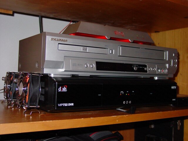

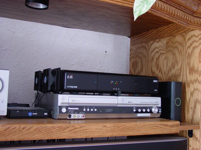

The inlet and outlet vents are on the *side* of these units, so space there is most critical. You likely have little to no airflow inside your cabinet though.
Many people, myself included, use (used) "laptop coolers". Those aren't made for 24/7 operation though. Mine got too noisy after a little over a year and I threw it out.

I don't think these ideas would work all that well as the vents are located along both sides of the unit, not the front of the back. Laptop coolers tend to work well as they tend to cool the receiver housing and keep the temp inside the unit lower.

fatmikla22. What's your avarage temp? You may not even have an overheating problem. As for raising it I put a roll of electrical tape under each corner. It raises it 1" and looks like it came from the factory that way. You know like some DVD players and stereo receivers have those "feet" under them. Like that. The avg. temp went down 2º to 109º which I think is pretty good.
Oh, and I had one of the laptop coolers for about 8 months too. It got real noisy and I took it apart, cleaned the dust out and oiled the motors and it lasted another 3 and finally gave up. I think I got my $15 worth out of it before I threw it away.
