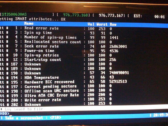

Last week my 622 stop recognizing my EHD. I am getting "This feature is currently not supported" message when I try to access "My Media". I removed the Seagate 500G HD from the EHD enclosure and connected it to my PC. I ran a scan and remap on MHDD. I have attached a photo of the SMART values as reported after the scan. I have no idea what these mean. Thanks for the help.

It's looking good: #5 is 0,#197 and 198 = 0. One advise - keep it cool, now its temp is 45 C.
As to problems with 622, check connecting inside of the EHD and use better USB cable. Could be power brick issue, but you'll need to measure rail(s) and ripples/noise for that.
