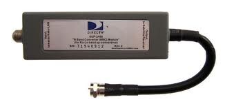

EDIT: I notice that some ads on Ebay say things like: "HD RECEIVERS NEED BBAND CONVERTER TO GET ALL HD CHANNELS". What does that mean? Do I need something besides the SL3 slimline?
If you did your sd install, you can do the hd one. It's a little more complicated, but you can handle it, no doubt! You should get a sl3 that has four outputs, but just connect two of them, any two will do. The b band converters are necessary. Directv should sent you two with no problem, and no charge, too. They look like this:
