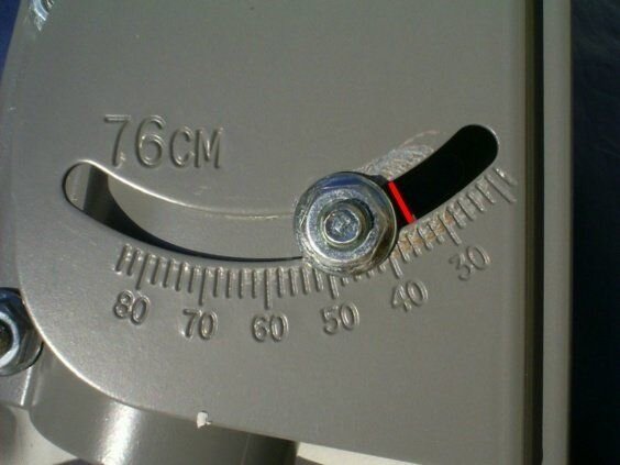

If its the Winegard DS2076 make sure to use the red mark when setting the elevation
