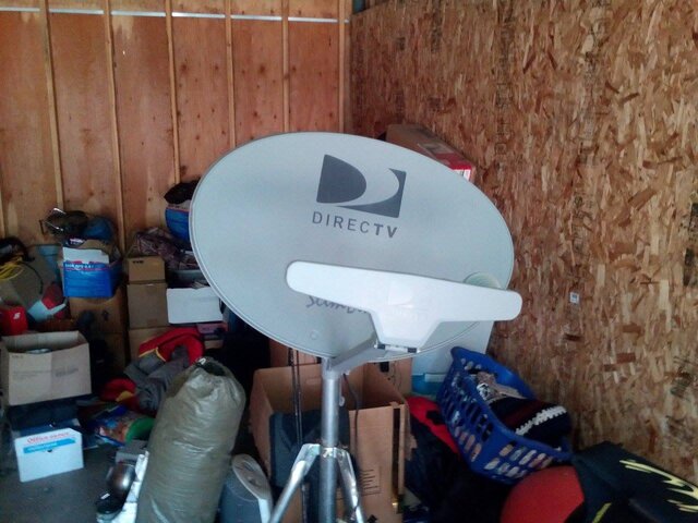

I'm using this in our travel trailer so we have the tripod. I have been trying to aim this at our home before our trip so I can learn how it all works but it's not working. I have it aimed just like the dish on our house. But can't get any reading what so ever on the single screen. Not sure If I'm over looking something. Thanks for the help

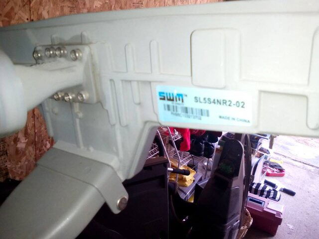

And as far as dish, I'm using this dish and tripod. And yes I have the power adapter for the SWM. And yes using SWM in my trailer. I took the H24 Box out of the house and put it in the trailer.

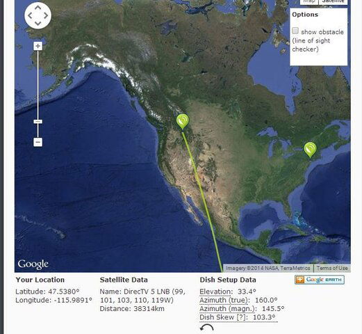

Here is what it says now:
Satellite: DirecTV 5 LNB (99, 101, 103, 110, 119W)
Elevation: 33.5°
Azimuth (true): 160.0°
Azimuth (magn.): 145.5°
My Zip code is: 83849

What about the tilt/skew?
Sorry, not the bottom of the page, bottom of the map.
103.3 skew on dishpointer.com. But, even if OP puts skew at 90 for 101 he should get all the SDs just great. (Stupid me, I did not look at the pic in Chip's post. Same as what I saw.)

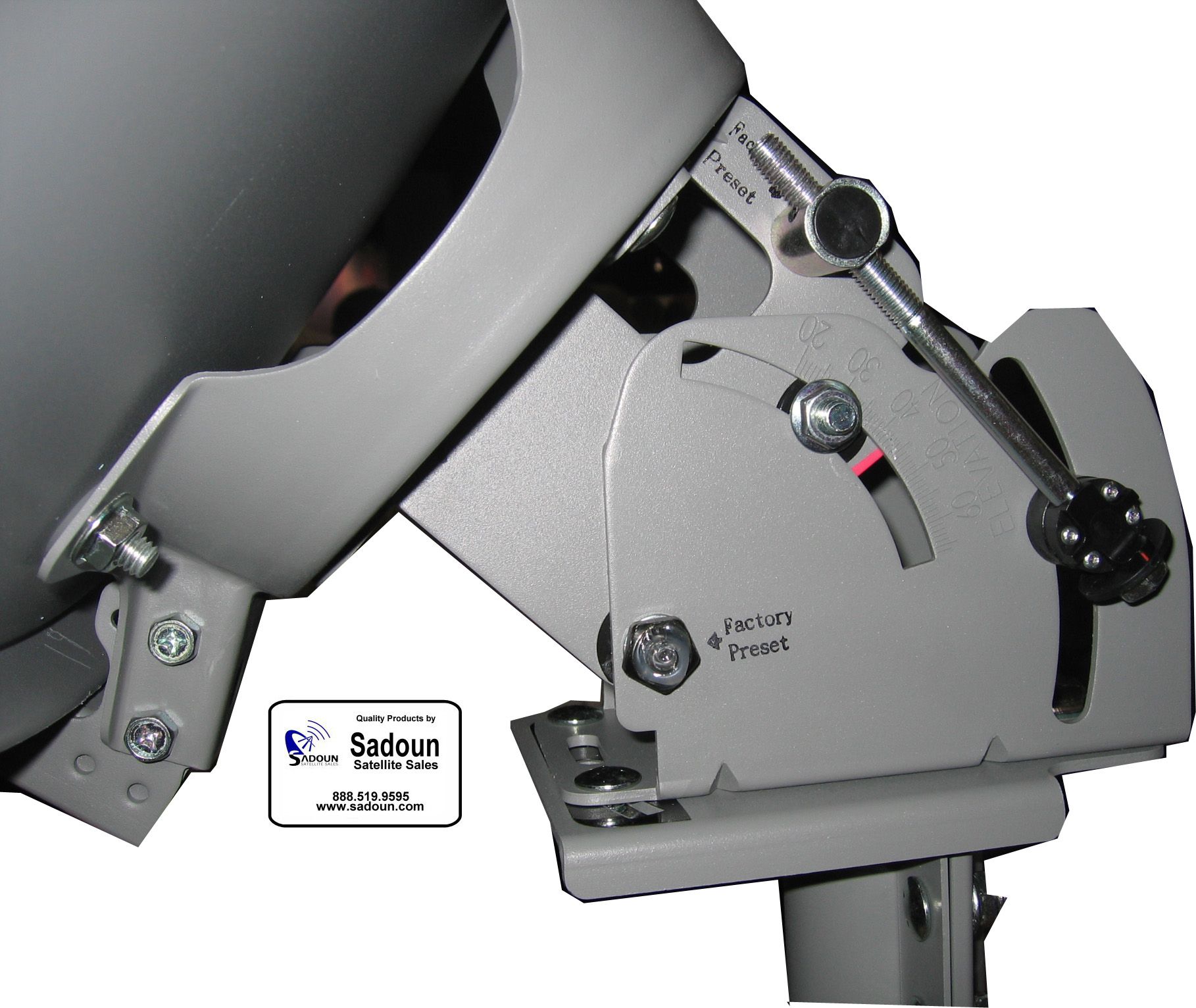

Are you sure you are using the correct mark for the elevation setting? It's the edge of the metal slider, not where the bolt is....
That is the one I don't understand. What part of it do I look at ? Some of the others that are the same as mine are lifted on blocks. I wonder if I need to tilt mine ?
Check the picture I posted. Some have a line making it easy to tell how to adjust the elevation. Others use the edge of the bracket, but don't have the line on them.
Chip's picture shows the correct elevation marking. And no, you don't need to lift it on blocks. Make sure the post is completely plumb, and then set the correct elevation to the edge of the bracket.
