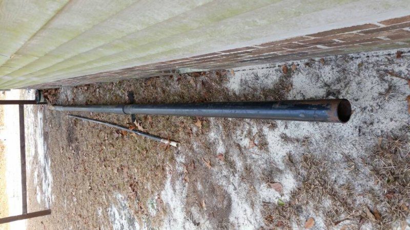

Well guys we purchased a new home while back and havent set up my 10 foot dish yet. I needed a longer pole and found one after searching for a few months. Old high school buddy had a 24 foot pole that had a 10 foot dish on it. Dish was gone but pole was still there. Got the pole today. Was hell getting out of ground. Could have been worse. Luckily the cement was not poured evenly around the pole. One side i was able to bust concrete off and pole came loose from cement. Anyways i plan to sand down the rust and paint the dish etc. Will post my progress on the painting and install in this thread. Here is pic of post .

Wow that is a big ass pole!

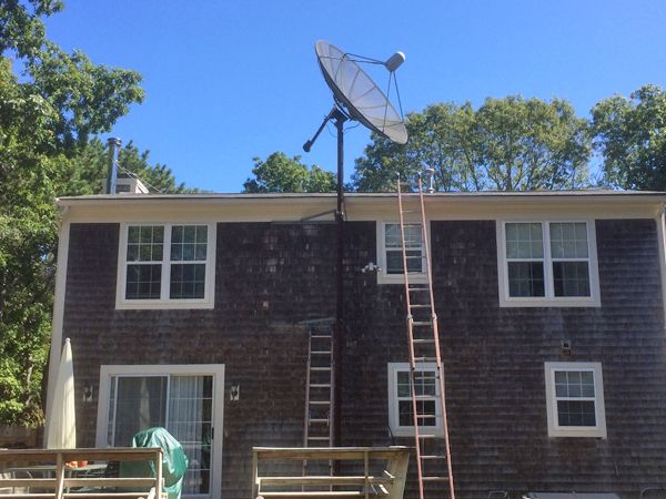

Good luck with your new install. Just remember, servicing that dish all the way up there could become difficult.
I had my dish on a 20 foot pole, attached to my house for 15 years and as the years went by it became more difficult...aka I got older.;)
I eventually lowered it to an 8 foot pole. A few less satellites...yes...but a lot easier to maintain.

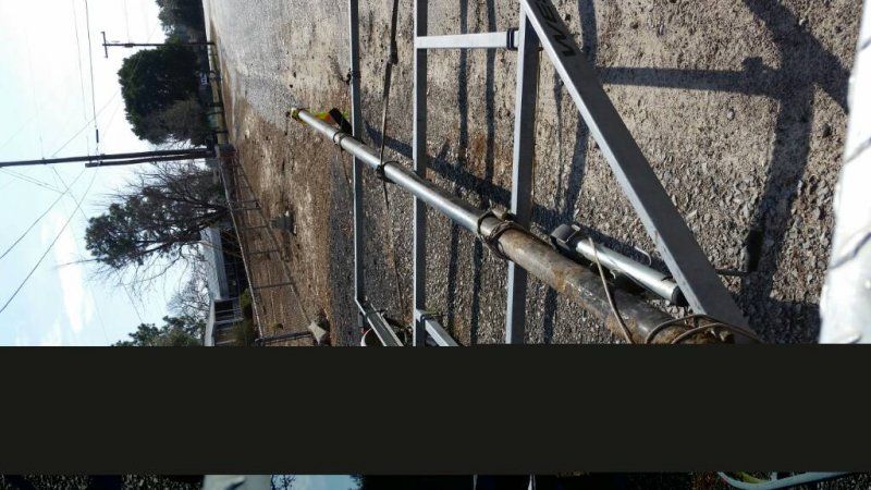

Yeah, luckily im in the type of business i have a man lift. I figure once i retire ill keep a few peices of equipment and the man lift will be one of them. After several hours of being on a ladder i decided it was worth it to use the man lift to mess around with my feed on my dish, also helps with a lot of other tasks you would otherwise be using a ladder for.

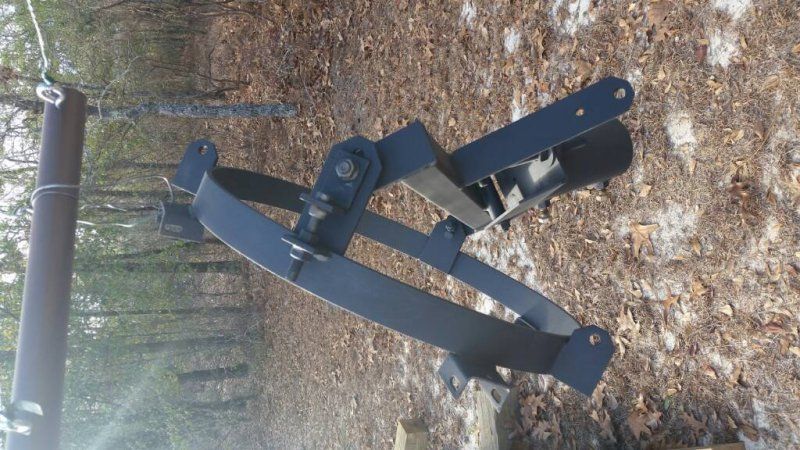

I like the way that you have an infinate declination ajustment on that mount . One that I brought home had just three holes to use and that was the only adjustment on it.
I brought one home that is that way too, ill be modifying it before i install it.

You might want to check it first. It might have just the amount of adjustment that you need.
Its possible, but very unlikely that one of 3 holes will be the magic sweetspot for the declination I need. Im sure back in the analog days when it was installed it was close enough. To my mind its easier to weld a few peices of angle and install a bolt to adjust declination for fine tuning before i install the dish then to install a dish and find that one of the 3 holes doesnt work.

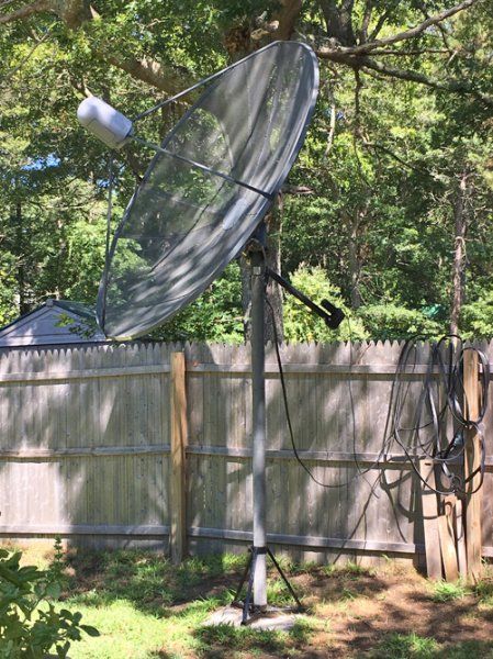

Nice work so far on the dish. I just moved to a new place too and got my dish moved before selling the old house. I got an 11 ft pole from work since I work in a steel shop. The soil is 95%+ damp beach sand so I put 2 cubic yards of concrete 6 feet down. I assembled the dish completely on the pole barn floor to keep it true, and built a sled under it, and towed it out through the snow with my jeep. I happened to find a cool guy 1/4 mile down the road with a boom truck so he helped me lift it onto the pole. I myself don't like attaching a dish to a building but that's just me, it's been successfully done many times. My dish has infinite declination adjustment too and it's nice because I notice quite a difference with just 1/8" of adjustment.

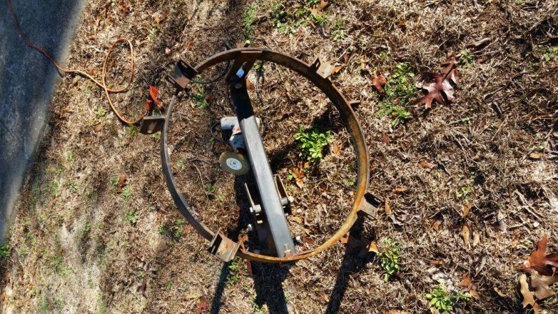

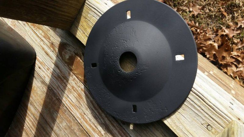

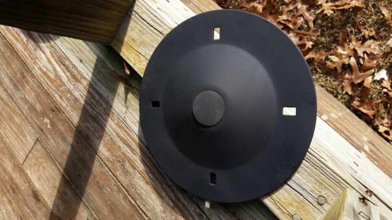

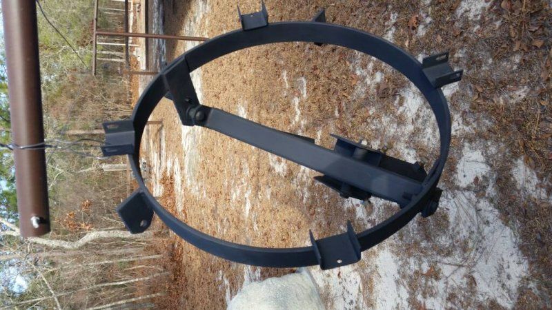

Weather was nice in SC this afternoon, Got up to 60 degrees. I got one coat painted, on one of the four pannels. This pic was before the paint. Suppose to be 72 degrees tomorrow and 76 Sunday. I should get other three pannels bye Sunday.

Hey, that only makes you 62. Don't give up so soon. I just got to 70 and still go up my 80 foot ham tower.
As for your project: Looks real good. Will be interesting to see it develop.
