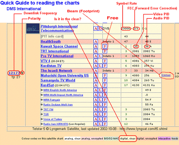

Have a look at the below picture so you can read the Lyngsat charts yourself :)
Knowledge is power!
C-Band needs a 6' dish and use a 4 digit Freq.
Ku Band needs at least a 30" dish and use a 5 digit Freq.
