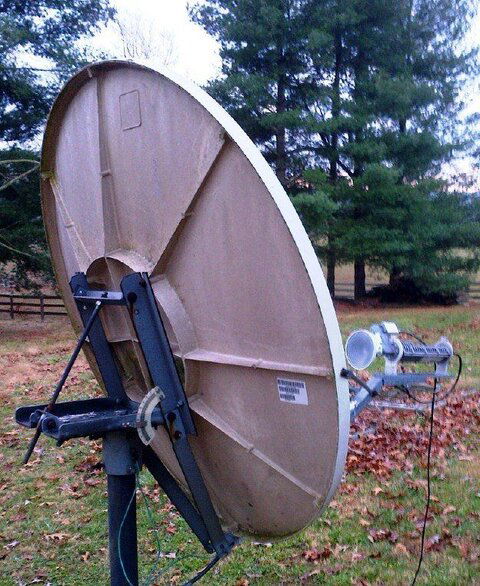

Yesterday I saw trucks and backhoes at a local gas station - - - it looked like they were going to tear down the place. Of course I stopped and asked if I could have the dish on the back of the building. The guys said sure and I could get it tomorrow.
So after work today I went back got the dish and the pole it was on. Dish is over 4 feet across. I'm wondering how I might motorize this beast.

chapelrun said:
...I went back got the dish and the pole it was on.
Oh, round. I can tell from the feedhorn.
Out here, most gas station dishes are 4' wide rectangular Prodelins.
Judging from the feed arm, I guess you 've got a round 1.2m Prodelin.
First rate dish; congratulations!
Kinda heavy.
I'd strip as much mount as possible to reduce weight if considering a DG380.
Maybe fabricate your own bracket (it's been documented on the forum).
Alternately, you can graft the dish to a BUD mount and drive it with a jack.
Talk to TurboSat, he did one that way. :)
Yep, primestar said it, don't think the 380 could handle it for long without some major strip-down. Seems like 25-28lbs was the rated maximum weight, can't recall where I read that. You might be able to achieve it by removing the mount, using a square piece of aluminum or something like that. Polar mount would do it nicely, too.

I have that same 1.2M Prodelin, and it is HEAVY. The dish is thick, even for a molded dish, and the mount and LNB support arms are monstrous. I would recommend aiming it at a favorite Ku-Band bird and leaving it stationary.
After moving the dish from the truck - - - I think you are right!

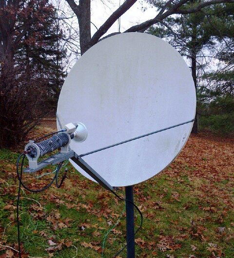

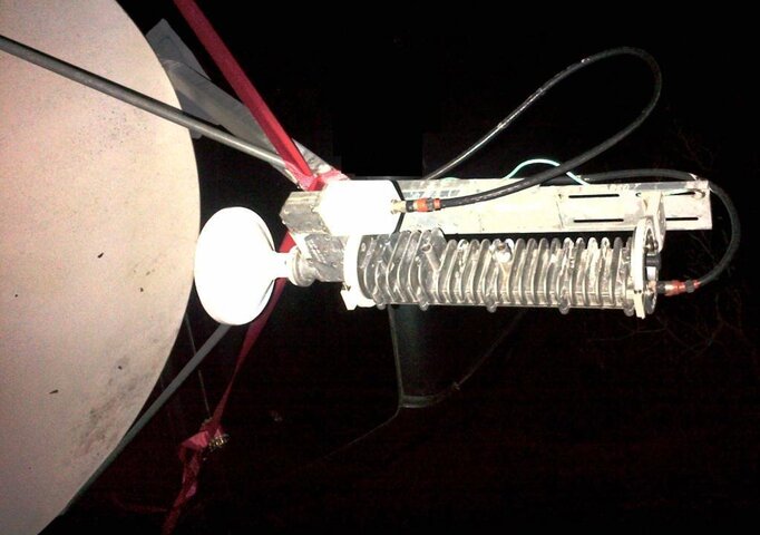

Today I got this dish up in the air and pointed at 103W. The way this dish is configured I can only get one polarity, in this case H - - - but that is OK because everything I want is H.
At first I was not getting any NBC channels to scan in - - - but then I rotated the LNB 26 degrees counter-clockwise (standing in front of the dish) and they came right in. I don't think I have the dish dead on yet but did pretty well considering it got dark so early.
Maybe some PIX tomorrow.

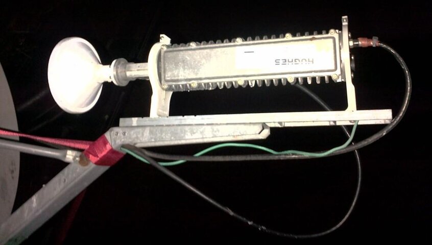

I suspect you'll be satisfied with the original LNB.
So no reason to graft that feedhorn to a newer LNB, then have to cobble up a way to mount it.
Poke it with a fork; I think it's done! ?

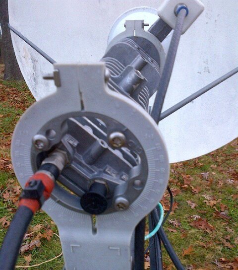

You are definately correct!! The setup to skew the LNB is so cool. You loosen two screws and you rotate the LNB anywhere you want in about 10 seconds. Tight the two screw back and you're done. Very well engineered Prodelin dish.
Some PIX
Here are some PIX of the dish. Notice the skew adjustment on this dish.
