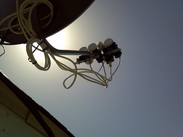

Using the winegard ds2076 I've got these 4 sats kind of 5 really. The funky p170ku+ from Eagle aspen is picking up 91w and the trece channel from 93...Kind of odd. I've installed these during cloudy days. Once even while raining.
I'm just tired of everyone saying to everyone else who is starting out in FTA that their dish is too small. I've been told that repeatedly. But I'm having fun and think I'm doing it well.
But just in case anyone is looking to get rid of a 39inch dish and or a motor I'm listening!
On my stb though, it has two diseqc spots. one does four way. One does 16 way...So will it work with the 8x1 or where do I find a cheap 16x1 or 2 or 3???
wsi lnbs x2
eagle aspen p170ku+
Amiko premium L104
X2 Premium STB
one ds2076.
One no name diseqc 4x1 switch
wsi lnbs x2
eagle aspen p170ku+
Amiko premium L104
X2 Premium STB
one ds2076.
Nice work! Most recommend starting on a larger dish to make it easier to lock channels and get the maximum return from the investment in equipment. If people get frustrated because they can't receive channels, they may abandon FTA and that's not good for the hobby. We are all free to experiment and I guess that goes to prove that if you are willing to put the extra effort into it and can get channels on any given dish then it isn't too small. Again, nice work!:)
Reactions: Wayn23
The reason people warn others away from smaller dishes is to help them avoid disappointment when they are unable to receive some channels they were hoping to get, another thing to consider is that signal strength can vary depending on your location, what might come in for you might not come in for everybody, even if they have identical equipment.
Think of it this way.... someone asks you to recommend a good reliable vehicle for their family. You reply that they should by a Vespa scooter' because it can be driven on a road, gets good gas mileage and they could choose one kid to ride with them. Yes, both are modes of transportation, but will the person be helped by your suggestion?
Smaller dishes can be used to receive many channels reliably, but a reflector that is smaller than 90cm has a beam width that is wider than a single satellite position. Many channels will be difficult to receive because of adjacent satellite interference and other channels will not be received because the signals are to weak to be received on that small of reflector. This is the reality of link budgets and reliable reception. I can receive several 97w KU transponders with a 18" dish, but would I recommend it for anyone wanting reliable viewing? :)
Glad that you receive the channels that you want with a smaller dish, but you would be doing a disservice to recommend an undersized reflector to a newbie. For the minimal cost difference between and undersized dish and an appropriately sized dish, why suggest something that will not work on certain popular channels?
Reactions: jmc98
Unfortunately you'll be limited on what you can hit. For over a year, I played around with different scenarios on my 76cm. I currently have 101, 97 and 91 but I have had as many as four lnbf's on the one dish at once. I've been able to get 105w through 83w without any issues. I've attempted as far west at 121w. Could have gone further but my house prevents me from doing so.
Eventually I got a 1m and with that one I placed 4 lnbf's on that one (103,99,95 and 87).
I believe I am more confident because of the challenge which was presented to me at first; small dish with limited knowledge and a wife who was not that supportive.
Anyway two years later, I am still playing and enjoying what I've started. Even my wife enjoys some of the programming.
Now I'm waiting for a larger; preferably a 1.2 for the cband on a small dish stuff. Good luck and have fun.
Reactions: FTA4PA

One overlooked factor is that a small dish is at the mercy of changing weather in particular rain fade.
If you depend on FTA as the primary source of TV then the small dish will be a disappointment and huge source of aggravation. My 25" dish does quite well receiving Hispasat 30W until it rains. Then it disappears. The 33" is more tolerant but also experiences rain fade.
If you live in apartment like I do space is tight so small dishes are a must. I reuse old dn dishes they work alright but not a great as a 1 meter dish.

I use both, 4 x 1 and 8 x 1. I have the three lnbfs on the small dish using the 4 x 1 with the output going into one of the inputs in the 8 x 1. The larger dish has the other 4 lnbf's feeding into four inputs in the 8 x 1. Then the output from the 8 x 1 goes to the receiver.
This did not work with by Traxis 6000 HD but it did fine with the Amiko Alien 2. My Amiko Nano had some issues with the switching.
