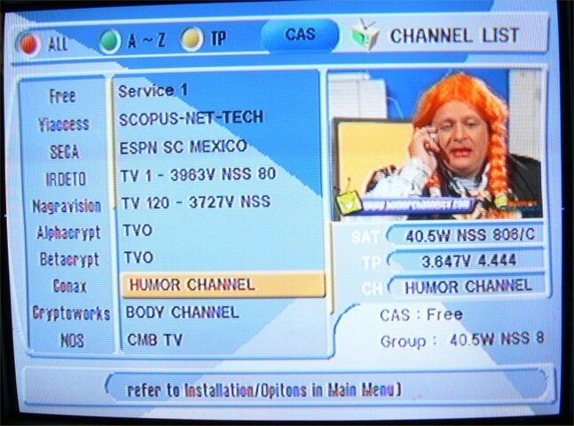

"Most responders are forgetting the original question posted.
NSS-806 was wanted.
That is not going to work with a 6 foot dish.
Nor will it work with a linear C-band LNBF."
No?

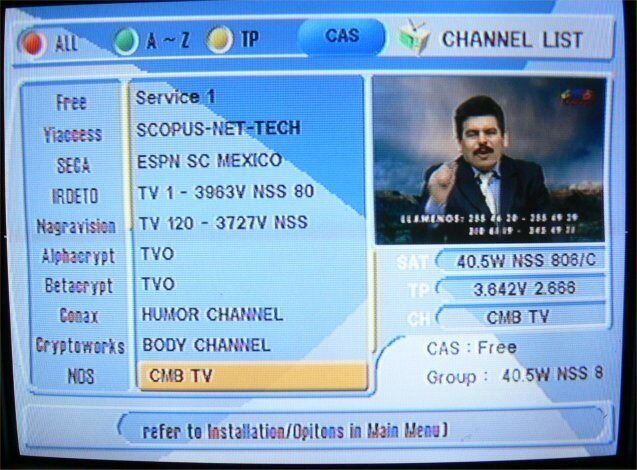

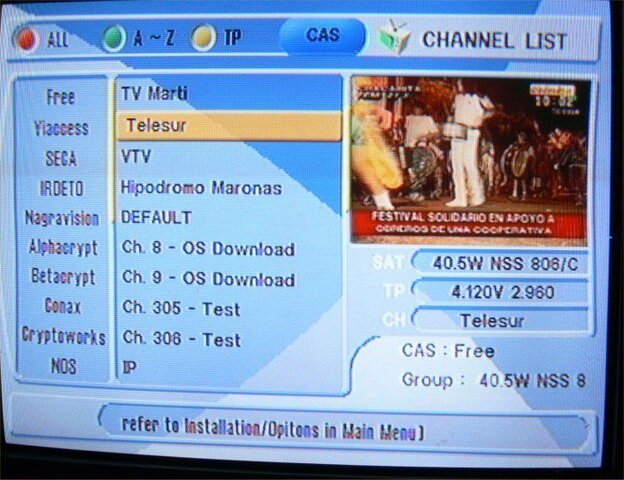

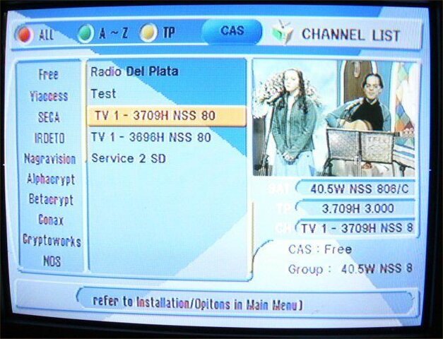

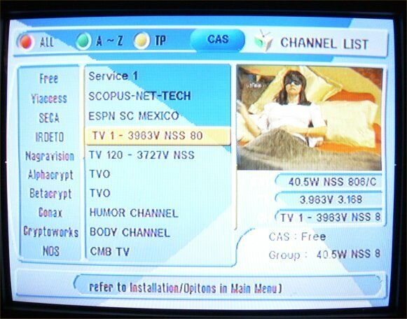

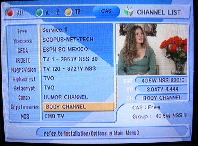

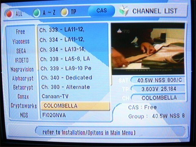

Yes they are stable Iceberg.
I have had great performance from the 6 foot Sadoun dish with the ASC421 lnbf, dielectric plate inserted for the circular sat of course.
But, I am on the east coast, that helps for those sats.
I'm impressed! I do have a working system here using a 10-foot Orbitron SST-10 and ADL CPOR-100, and it spoils me with most NSS-806 quality readings in the mid 70s or higher (on a Traxis DBS-3500).
I tried using a C-band LNBF with dielectric plate and a 10-foot SAMI antenna in Atlanta a few days ago, and found it extremely marginal, with many channels unable to maintain a solid lock. Taking the dielectric plate out, no problems on neighboring 37.5, 43.0, 45 or 55.5 West. Using a dielectric plate for circular C-band is very critical, because there is a very small window in which it works acceptably, and obviously you have found that spot.
Based upon previous experiences of others, as well as my own personal experience, I would not have attempted it on anything less than an 8 foot antenna, so my congratulations on your success.

I have a 6.0 ft Winegard mash dish on NSS 806 .
A C-Band feed horne with a dielectric plate and it works good.
