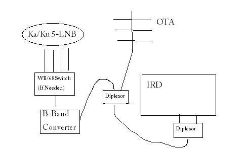

Diplexing DOES NOT work with the Ka/Ku DBS setups. You will need to run dedicated OTA RG6.
Diplexing will work as long as you install the b-band converter before the diplexor.
See attached illustration
