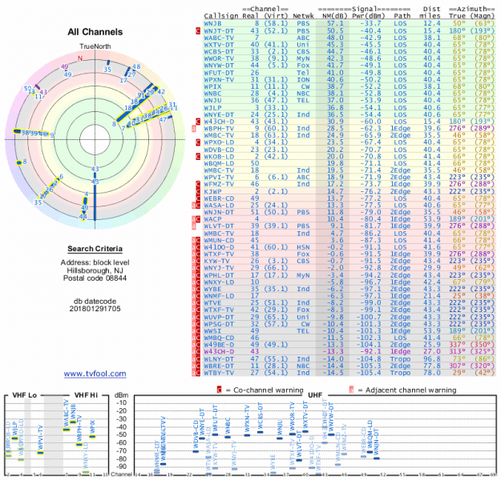

I currently have Comcast basic cable as a backup to Dish (for days like today when it is snowing in NJ and Dish keeps going in and out). I thought I'd try an indoor antenna to eliminate the cost to Comcast (I hate them) and an outdoor antenna doesn't make sense for the infrequency that I need a backup.
I ordered the following from Amazon (link wouldn't work from there so I think this is the same one from somewhere else): HDTV Antenna Indoor Digital 60-80 Miles Long Range TV Antenna with 2018 Newest Type Switch Console Amplifier Signal Booster, High Performance 16.5FT Coaxial Cable Power Adapter Better Reception
Results weren't great. On the second floor I got spotty pixelated coverage on NBC, CBS, FOX, WOR and a few local PBS type channels. No ABC or CW. When I put it on the window (not really what I'd like to do) the pixelation stopped but I still didn't get the missing channels. Tried several different locations and channel scans not much difference. My TV Fool is attached.
My question is would a different indoor antenna yield better results or is it just my location and not worth the bother?

It does not specify VHF or UHF in the description but does show the ABC and CW logos. Supposed range is 60 - 80 miles and it has a booster with short (30) and Long (50). Tried both.
The logos mean nothing, just that you 'might' receive channels like it. Once again, just because the say you 'might' receive channels 60 to 80 miles away means nothing in the real world.

Those mudflap antennas never do well for VHF, which is what WABC is.
Might be worth checking out a decent set of rabbit ears with VHF capability. RCA makes some good ones. Add a distribution amp or inexpensive preamp if needed. I have 3 of these: RCA Antennas : Indoor HD Antenna : ANT112R
2 of them are in use at a friends' house. They do well on VHF less than 45 miles away, so you might get WABC with one of those. Walmart has them IIRC

I used to think rabbit ears seemed outdated and quaint, but honestly they perform just as well today as back when we were kids. Case in point: I've been on vacation in Ohio this week, and I brought with me rabbit ears and also a mudflap antenna (similar to what you have). I'm between Dayton and Columbus and I can get all the locals from both cities with just the rabbit ears I told you about in my previous post. I then combined those rabbit ears with a TVPRAMP1Z (see here: Shop RCA HD Television Tuner at Lowes.com) and now I'm even picking up the low power stations from each city.
Sometimes simple (and old fashioned) is good!
PS- the mudflap I have was $12 at Dollar General and it does a pretty darn good job on UHF stations too, when combined with a preamp. The downfall is mudflaps don't do VHF.

Much past 30 miles indoor antennas have so many disadvantages that they work very poorly, walls filter signals out refrigerators, ovens, stoves, AC/Heater units reflect signals, even the human body walking around indoors can reflect and absorb RF signals.
This is why an outdoor antenna is encouraged, especially if you want stable picture/sound 24/7.
A small UHF/VHF all channel antenna mounted above your roof line can be had for less than $100 installed (don't buy cheap Chinese junk even if it promises 100 mile reception - LIES).
