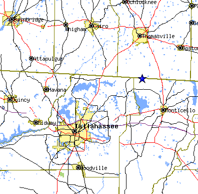

The results I get for 32305 show you close to South Monroe Street @ Apalachee Parkway in Tallahassee; so that places the airport to the SW of that zip while the tower locations are to the NE.
WCTV (CBS) & WTWC (NBC) towers are physically located near METCALF , GA (BLUE STAR) some 30 miles away and one UHF / one VHF. ABC is in the same 43 - 45 degree heading at about the same distance. WTLH (FOX) is also in the same direction & distance but I did not see their DIGITAL tower spec, but did see a FCC construction permit; are they broadcasting digital yet? WFSU (PBS) & WTLF (IND) are much closer but in the other direction; 275/325 heading.
I think the only worthless thing was the installer and that cheap-o antenna he had. Seems you need a quality, roof-top, med/long-range, VHF/UHF combo. Like maybe:
Channel Master CM 3678
Channel Master CM 4242
Winegard HD 7084P
Winegard PR 7042
Our Fox is WTLH.
I live approximately two miles to the east of the airport, and a little to the south.
I'm beginning to think that the installer just didn't want to do the install!!!
