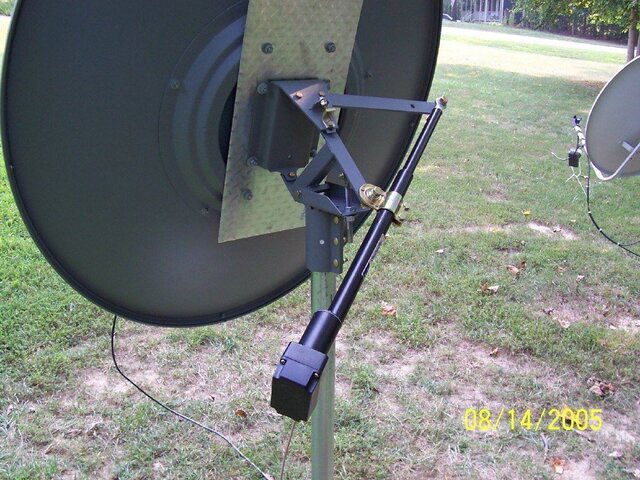

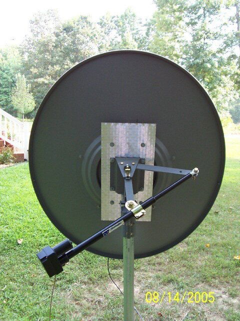

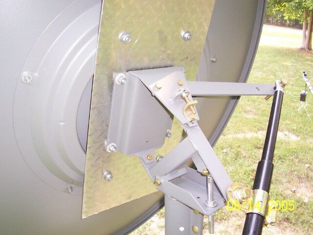

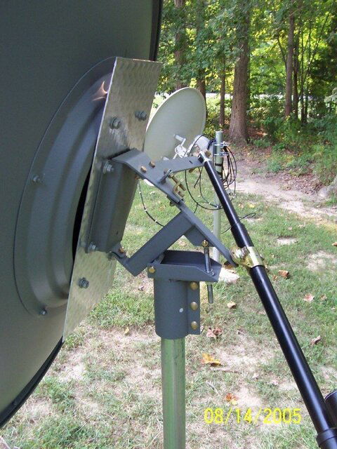

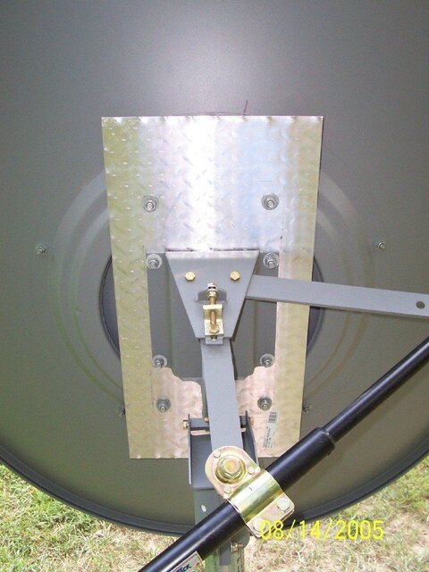

Assembled the CM polar mount with aluminum adapter plate and mounted on Patriot 1.2 meter dish. This baby really moves now. East to West extremes in about 10 seconds or less. Had a heck of a time getting it set up and tracking the arc properly as this was the first polar mount that I have set-up before, but I can see PAS 9 to ANIK F-1 reliably. I really miss USALS because with the BUD actuator and V-box you have to use 1.2...cool thing is that you can really fine tune in each sat with the buttons on the V-Box. The aluminum adapter plate is temporary as it is the only thing I could find at Lowes that was suitable. Will be going with 1/8" steel plate when I find the time.

Thats a very nice setup cascade, ill bet it would work perfectly for my p* :-D
I SO have to do this. My Sg2100 just cried and refused to go East for me. Removing the Patriot makes it act normal again, I think the weight is just killing it. Ok, I KNOW the weight is killing it :rolleyes:
Need to find a cheap polar mount and actuator... you can still save positions using the v-box and 1.2, right? Not having USALS won't bother me, I never have USALS :p
What type of cable does the DP 710 V-Box controller use to control the actuator? Does anyone have a picture of the back panel on the DP 710 V-Box controller that they could show us?
What size actuator arm did you use rayydio?

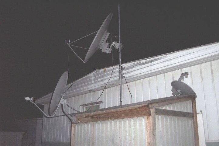

My work-area is as attached. I'm trying to figure out the perfect mounting method in this location. I have an idea for it, and would love some advice... I have a 1.2m Patriot, much too heavy for my SG2100, so I'm getting an actuator, V-box, and polar mount. The V-box I'm getting from PSB becuase he rocks and has it cheap ;) The actuator can be had from ebay for under $40, but I'm stumped on where to get the polar mount from. That's one problem. The next problem is the actual mounting. The shed is very sturdy, and I keep thinking that a tripod deal, braced to the house for extra measure perhaps, would be ideal for my MicroBUD. But all the tripods I find on ebay are flimsy and made for DBS dishes. To remind everyone, sinking a pole into cement in the yard doesn't work in my situation. This is the only viable location until we move (someday).
In the meantime, I took the setup in the picture down. While the pole worked fine as shown in good weather, the wind picked up tonight and I decided I didn't trust it, too much movement. Yes, I convinced the neighbors I was nuts again, scampering up in an oncoming storm, carefully lowering my dish to the ground... :rolleyes:

I used an 18" actuator and 4 conductor telephone wire. Telephone wire is cheap...06/ft and I have not had a problem with it so far.

Also, any thoughts on securing the bottom to the shed and overhang? I actually used one of the old side-clamp mounts upright on the shed, and slid the pole right over it... very temporary solution, though. If you look close, you can see I used an existing J-mount foot, a peice of wood and a bolt to affix the pole to the overhang. It held it pretty sturdy... except the pole could turn under enough wind! :p A tripod still sounds so much easier, but looks like I'll have to give up; can't find one sturdy enough.

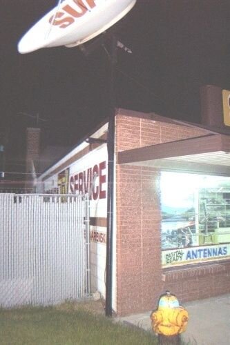

If I can find the proper stuff (namely, the uber-thick pole) I've decided on a mounting plan. I've seen about 4 examples of this within a few blocks of my house, so I know it's feasable. If I can find a 3" thick or better pole, I'll sink it in the ground next to the shed and/or house, affix it on, and mount my MicroBUD on top. With a setup like that, if the neighbors or park owner doesn't throw a tantrum, I may eventually upgrade to a 180cm dish! :D Now that I'm getting a v-box, actuator, and polar mount... why not? :p Still don't think I could get away with a 12' BUD, but I can dream.
Only issue is finding a good thick pipe to use. I went down to Home Depot today and all they had is 1.5" aluminum garbage that would be possibly suitable for DBS installations. I keep thinking that this type of piping looks like old-style plumbing pipe, but of course nowadays Home Depot only carries plastic drainpiping. So where do I get this thick stuff? (Please don't tell me to ship it, I need a 8ft peice, lol!)

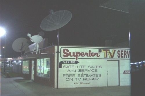

Attached are two photos I just took from the satellite shop up the road. I have no respect for them becuase they only sell Dish and DTV stuff, don't understand or know about FTA, downtalk to me, and (worst of all!) both the BUD's on their store aren't even in use!! lol... but the type of install I want to create is done twice there.
