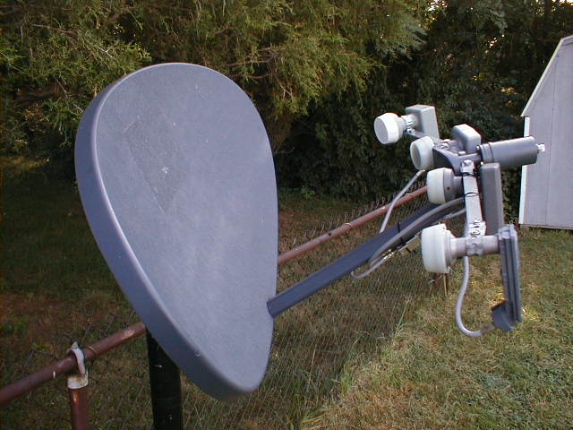

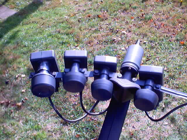

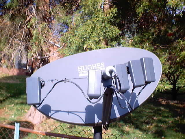

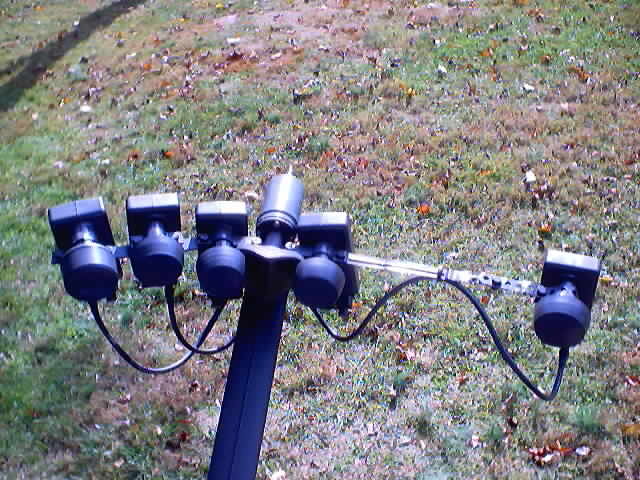

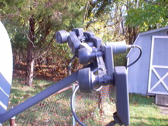

This is my 33 elliptical dish made by Hughes, receiving satellites from 61 w to 119 w.
Well it works, 61w, 91w ,97w ,101w, 110 w,119 w. and that's on a 33 dish.
Please tell us more about your mount config? Parts etc... Thanks I like what you did.
OK-I'm believing DK's picture and statement. He must be a good plumber to come up with that lnb assembly and mount. Hat's off!
The FSS satellites in this set-up are within 10 degrees (91w - 101w). I have had success of +/- 20 degrees with acceptable results.
