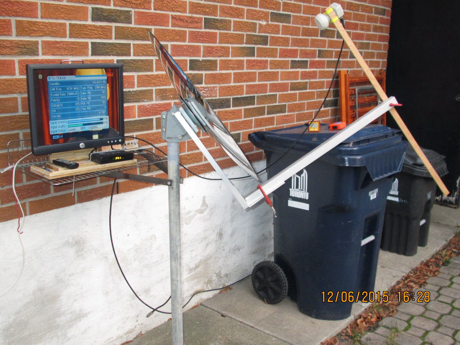

I got this plastic mirror from a friend, and tried it for satellite reception. S/Q is not very good, but usable.
It is spherical mirror, not a parabolic one, but it works. Calculated radii was close to 1200 mm, so, the focal
spot was set at 600 mm. LNBF holder is really mickey-mouse, but it was made for testing only.
Pictures follow;

Try 95W 11780 H 20760 if you get a chance. You may be surprised.
