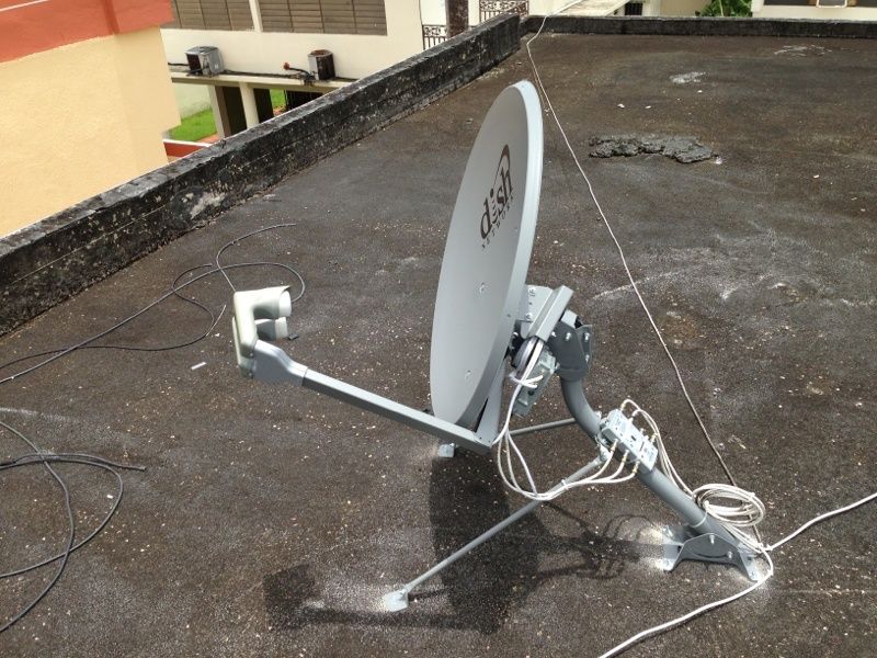

All is well now. Dish sent Coamo Satellite again and this time two techs came (very nice and friendly).
The techs knew the guy who did the install and they were shocked because that guy actually trained them! The problem was that he used the Y bracket from the new small antenna on one of my 4.5" which didn't have the LNB centered therefore creating signal loss. The techs were actually laughing and even took before and after pictures to tease him at work tomorrow.
I got a new dish and new wiring and so far everything is working as it should. Kudos for the friendly techs and an F for customer service at their HQ.

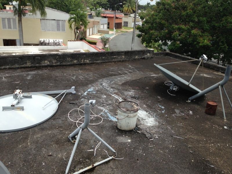

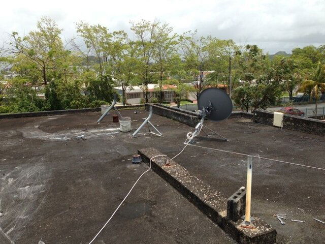

Just finished removing my old dishes, off to the trash they go.
