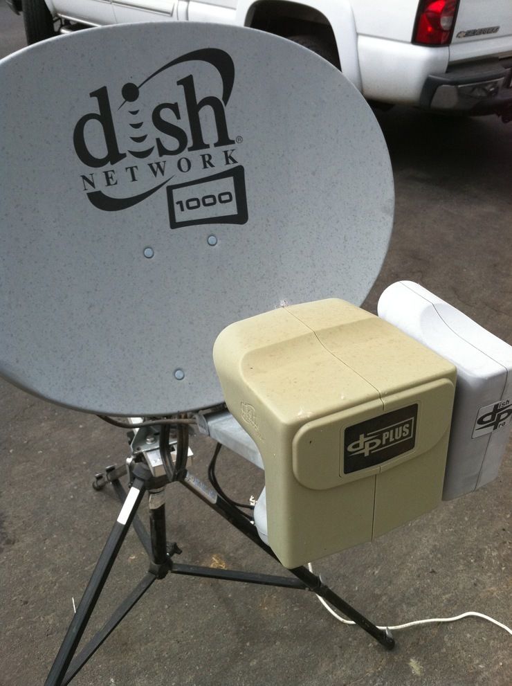

I have a dvr625 and a Dish1000 and I am trying to get them to play together so I can take them with me on my camping trip in the RV. I have another Dish 100 on the roof of the house and this is a spare one that I bought.

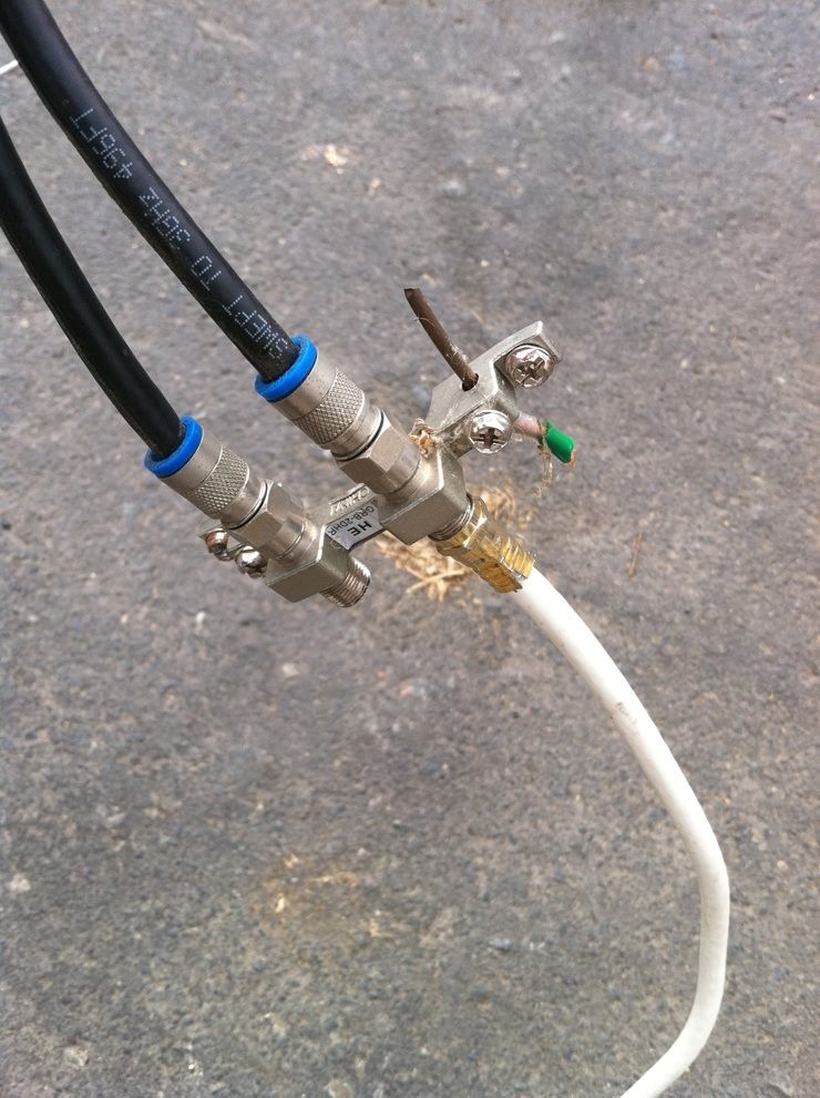

I have them connected like this. From the Sat lnb's there are two outputs. I took one of those and connected an RG-6, ran that inside to the reciever and used a splitter that is always on the receiver (in the house) and connected sat1 to sat1 and sat 2 to sat 2.

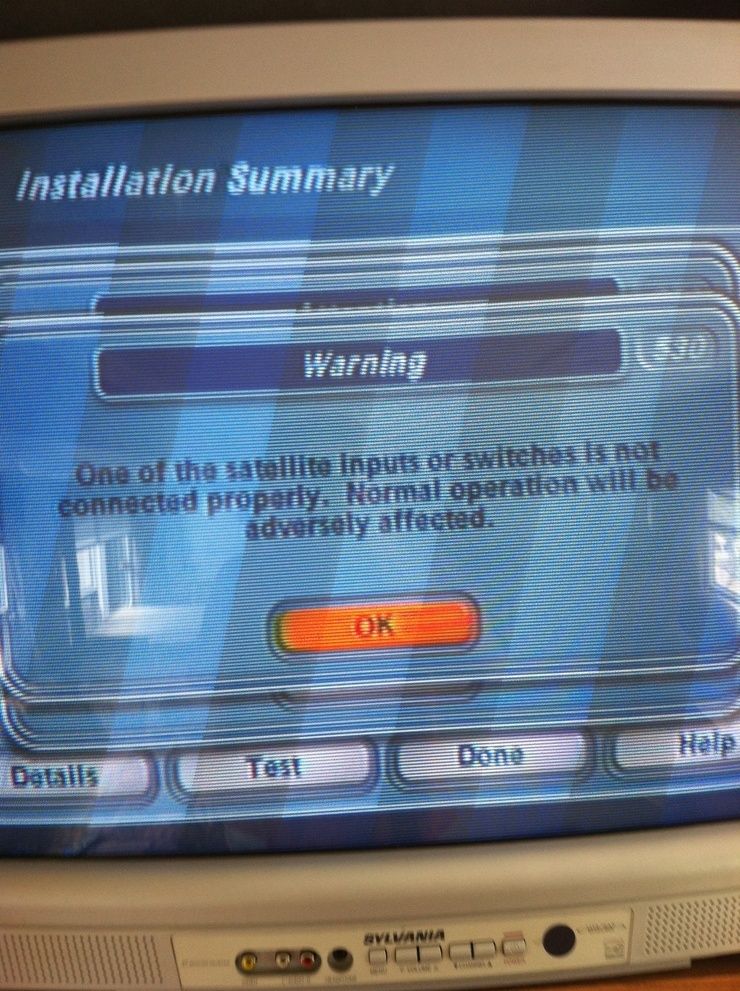

I then go to menu, 6,1,1 and choose check switch. I run three tests and I get a message530 that one of the sats or switches is not connected properly. I have tried 3 different cables between the sat and the splitter that I know are good and work fine in other places. Run is about 20ft.

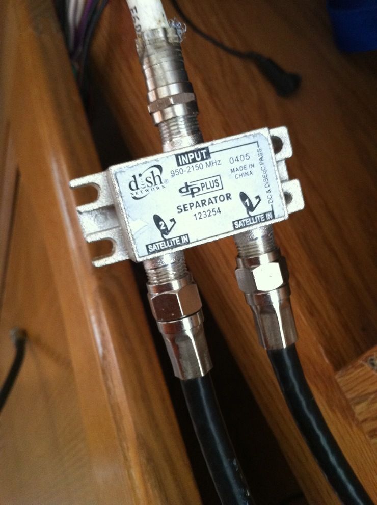

Do you know what LNB it has (I'm assuming DPP since the 1000.X's are DPP equipment)? On the install summary it will tell you under the "Switch" row. It sounds like you're using a separator (separator and splitter are two different things), just want to make sure you have a DPP LNB, since DPP separators only work with other DPP equipment (will not work with DP LNB).
If you're using a splitter, not separator, that may be the problem.

Yes, my Comcast FTp was/is having issues so the pictures were late. Hopefully they answer your questions?? If not let me know, and I can grab numbers or take more pics.

You should a coax running from the single LNB to the other LNB.. It will go to the input side of that LNB.. Is that coax there???
I do have that.

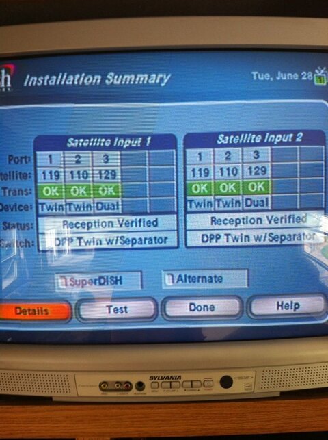

I ran the check switch again and got this:
Then click on details and got this:

and to answer an earlier question, here are my lnb's

By looking at the pictures it appears that everything is correct. Silly question but is this your normal receiver or another you had around? May need a hit sent. Is this receiver activated?
