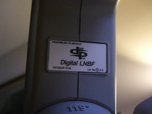

I'm trying to setup a dish on a flat roof since its the only clear view of the southern sky. I had rigged up the dish on some plywood and it seems pretty stable with some weight put on the wood. I cant seem to get a signal at all. Im not sure what im doing wrong though. I have pictures of what i have here so far , not sure how to post em on here.
- Video-path Multi-Dish Switch SW21 (123475958-AB)
- Dish Pro Digital LNBF BS1B2UP 101M (119)
- Dish Network Dish 500 Dish
-Dish DVR510 Receiver
I only have that single LNB hooked up to the 119 ,( Do i need dual lnb ??) I'm a newbie at this so any help would be greatly appreciated. Again , I have pics of the setup if anyone would mine helping me post em on here.

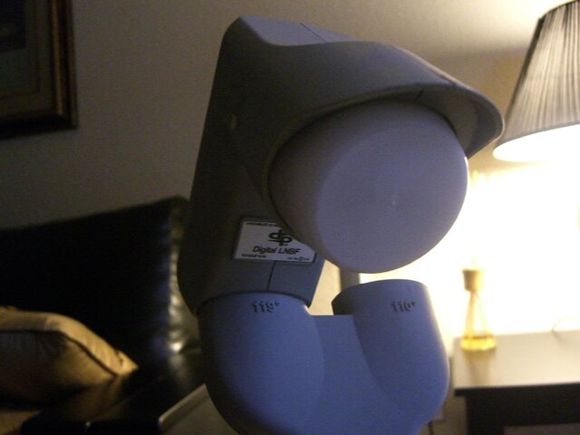

It sounds like you have a DP LNBF. If 2 RF connectors, its a DP Dual LNBF, and if 1 RF connector, it is a DP Single LNBF. I don't think the DP LNBF is compatible with that Legacy Switch (SW21); if it is, someone will follow-up with a post. However, as said, you don't need a switch with a single satellite position LNBF.
Since you state you have a Dish 500 dish, and you put the DP LNBF in the 119 slot, I would say you have the Dish 500 with the Y-Bracket which will let you mount 2 DP LNBF (single or dual) on it, or you can mount 1 DP Twin LNBF.
NOTE: Twin = 2 sats, while Dual = 2 single outputs for 2 single receivers.
I would invest in a DP Twin LNBF, which picks up 2 satellite locations, 119 & 110; has a built in switch, and will allow longer RG-6 cable runs.

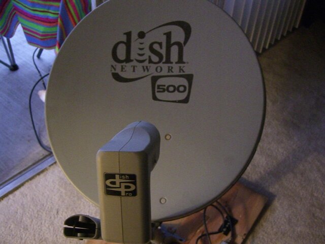

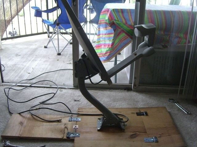

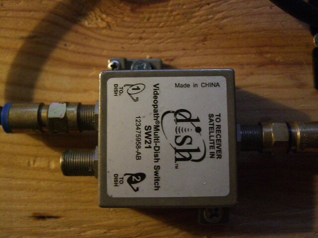

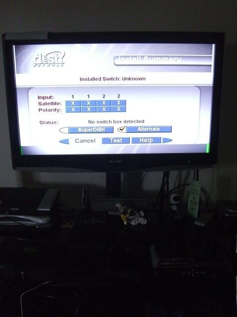

Here is where I am so far.. Also , should I be getting a " Installed Switch : Unknown " AFTER I have removed the switch and connected it straight to the lnb ? I used the Attachments button on top since its the only option I saw as far as attaching and uploading from the pc. Also , Im not sure how Im supposed to find the azimuth angle on the dish. I know that my Azimuth should be 209 , Skew 119 and Elevation 49. ( Zip code 77079)I got the Skew and Elevation since its easy to find on the dish but how about the Azimuth ? Thanks.

since you are just using 1 lnb, set the reciever to Dish 300 to get your settings. Skew should be 0 (or 90 on the back of the dish)... then set the elevation at whatever it needs to be, and move the dish very slowly side to side. Also, i'm sure you know this... but make sure the mast is completely plumb... or you will have to compensate on the dish itself
Birddoggy,
Using the Dish 500 with an I-Bracket for a single LNBF, I agree that he should use the Dish 300 settings and set the Skew to 0 degrees which would be 90 on the Dish 500.
However, since he is using the Y-Bracket, do you think he would be better off to set the Skew for a Dish 500?
Newyorkzxtc,
In the check switch screen, leave SUPERDISH and ALTERNATE unchecked.
How do you set the Azimuth?
Directly South of your position is 180 degrees. When facing South (180), to your Right or West would be 270 degrees.
- S === 180
- SSW = 202.5
- SW == 225
- WSW = 247.5
- W === 270
So 209 would be somewhere between SSW and SW if you had a compass, or estimate it (by which side of the trees the moss is on :D).
When using the Dish 500 with 2 LNBF's, the dish is aimed between the 2 satellites, and with the I-Bracket with 1 LNBF it is aimed at the satellite (for all practical purposes).
Just be patient when looking for the satellite. Move east to west slowly and watch the signal meter on the receiver. If it finds a satellite, give it time to tell you that you found the wrong satellite and hopefully tell you which one you found so that you know if you went past it or not. Remember, if you find the 110 satellite, you will need to twist the dish on the mast less than 1/8" to the West, like try moving it about 1/32"; and if you find the 129 satellite, you will need to twist to the East about 1/32" to 1/8" to get the 119.
nah, i'd use the 300 settings... its a big enough dish to pick up the 119 fine being offset. Back before most of the retailers around here started ordering I-brackets, we used an offset lnb for the 61.5 all the time (must carry for locals).
That said, if it was me, I would pick up a cheap DP or DPP twin off craigslist, ebay, ect... and set it up the right way

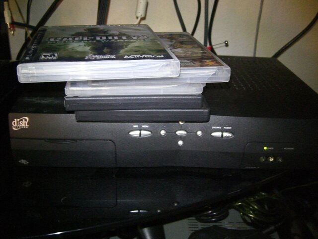

You should put the pornography away before snapping pictures in your bedroom. :eek:
Just kidding. I wanted to see how many people would go through those pics to try and see if there really was any in the photos.
I keep getting Echostar 110 West satellite. Moving it left or right just causes me to lose the signal all together. I have connected the switch I have and at least its catching something , without the switch im not even getting the echostar 110. :( Any ideas guys ???
Hmmm...
You shouldn't need the switch at all with only one lnb and its DP at that. But I'm not there and can't see it so leave it alone if its workin' I guess.

Hmm, you're getting 110 with the switch, and nothing without - I guess anything is possible.
I'm not familiar with the 510 receiver, but most are the same, so here goes....
Remove the cable from Sat-In cable from the back of the receiver.
Go to the Dish Point Screen and run a Check Switch, without any checks.
It should find nothing, i.e., no switch, no LNBF/Satellites. If it says it has detected less satellites - do you want to save, say yes and save.

Does the LNBF you currently have, have one or two RF outputs?

But we would still like to know what's working? :D Maybe a picture of your Point Dish screen.
Hopefully he removed the DP Dual LNBF (or DP Single LNBF) off the Y-Bracket and replaced it with a DishPro Twin LNBF and not have to use a switch, run a single cable between either DP Twin LNBF outputs and the receiver, and have both 119 and 110.
