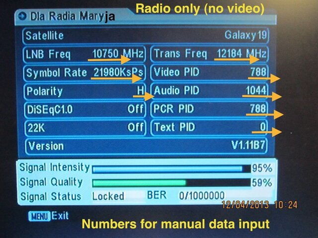

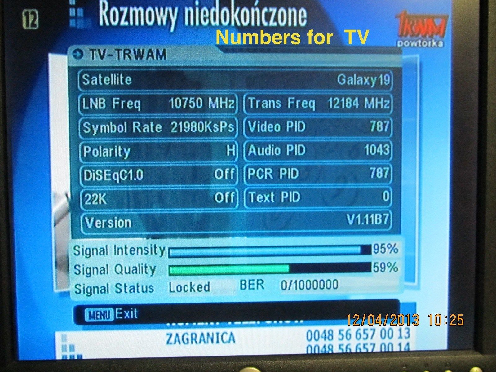

During the last 4 years, I helped maybe 20 friends to set up receiving these programs. Now, some of them need help again. I noticed, that there are receivers which can scan the 97 W, register 150 t0 200 TV's - but do not pull in the transponder where TRWAM is.
In this case, manual data input is helpful.
There is one particular receiver, Sonicsat Koolsat, which would not take other than pre-programmed frequencies, and is now useless...
The broadcaster probably agreed with uplinker to put his Radio program, "Dla Radia Maryja", together with TV broadcasts, despite lack of video in this program. This seems to make sense for switching between the programs, as only the remote button "up-down" is involved, without restoring to small remote button "TV-Radio".
I have no idea, if the fees for radio and TV are the same...
2 photos containing some numbers helpful for manual programming follow
