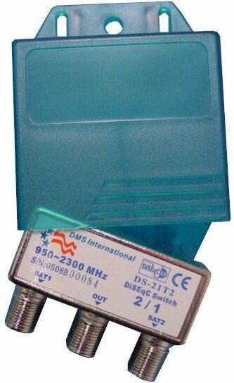

ok guys, Got the dish aimed and am receiving Galaxy10r... got good quality and strength, about 18 english channels... i don't speak any other languages so i don't need them, probably should have left the spanish on there to learn. anyhow, it was tricky. the settings are so tight, just 1/8th off and you'll lose it. strangest thing... had the original lnb from primestar with seperate v/h outputs. plugged into the vertical and i'm getting the vertical and horizontal... about 4 horizontal ones... kinda weird... and i don't understand it, but hey, i got channels for free.... HOW KOOL IS THAT..... now, i need to start thinking of getting a motor. i'm not really happy with where i mounted the dish, did it as a temporary thing... do you guys think i'll have any problems moving it about 40 feet from the house. where would you put the disqe switch, near the dish or near the house. THANKS GUYS.
40' should be nothing at all! I have my DiSEqC switch up behind my dish and motor, But its a good idea to have it out of the elemants, but many switch now come with weather covers :)
