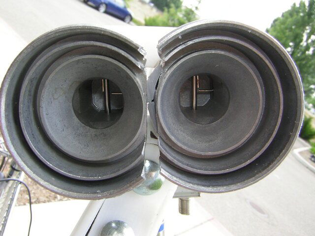

The LNBFs that you are using are too large and they cannot be placed close enough to resolve the 4 degree spacing. This is the reason that we developed the GSL1 LNBF. These are the smallest LNBFs available and will allow side by side placement without having to angle the LNBF.
You could also take a nippers or hacksaw ...... see attached photo
You're right!:eureka The size of the Globecast LNB is Big! As a newbie I never thought of that. At the highlighted; I'm afraid of taking the nippers or hacksaw to the LNBs as I may cut away too much or totally destroy them. I will take a look at "GSL1 LNBF" and see what that looks like. BTW, wouldn't moisture and rain destroy those open LNBs in the picture within a short period of time?:confused:
You are right about the units being damaged if the feed horn is left open. This was an experimental unit. You could cut the plastic caps and silicone together or cover the feed horns with plastic with breathing holes in the base.
