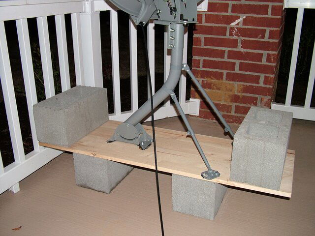

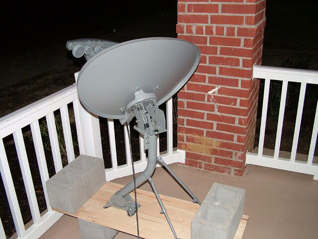

Nope, its on the balcony floor, not in the ground :S
Bummer, I paid 99$ for this tripod, (paid the dish network installer to buy it) oh well..
When the time comes right I will buy the right tripod for the slimline and I don't think there will be any fees for the installer to come and put the new tripod on since I can blame the old installer using mast and my dish losing signal, for now it works...but for later.
Well if looks are not important you could try this for about $20 and 15mins; I know it works 110% and is perfectly stable even in high winds (regardless of the naysayers that will slam its ugliness).
