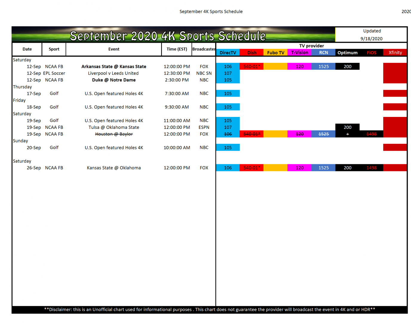

Oh, okay. I was confused by the chart in the other thread...
...showing that all of the Dish 4K events were from Fox. Also, there was your comment later in that thread:
None the less what I answered was that ESPN does have 4K when Don in CT said it doesn't exist. We sometimes see 4K sports from Fox, not FS1 or FS2, on our channel 540. There is no difference here. To answer half of Allen's question we don't have any ESPN 4K events because DISH doesn't have a contract with Disney, ESPN's owner to do so.
I'm talking historically. The last few years were far away more FS1 than Fox. I know that specifically because I watched most of those games in 4K by streaming FS1 on my Apple TV. The picture was simply better than the one I got from DISH.
