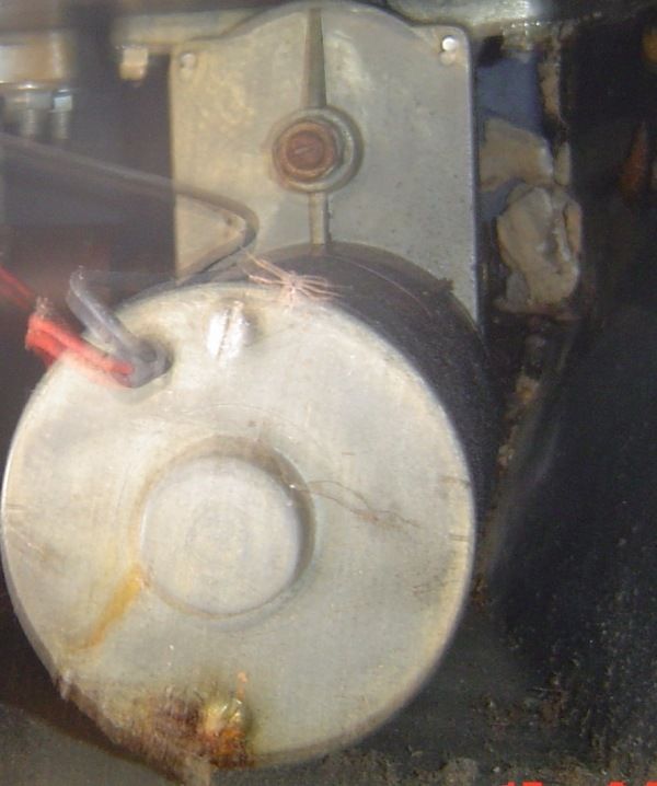

Here is a question for all you Guru's who have owned Birdviews and AJAK H-H mounts and motors, or similar motor mounts. :D
What is the little bolt on the gearbox with the set-nut for?
Here is a pic of the the one on the Birdview:
The AJAK mount on the Pinnacle has a similar bolt going into the gearbox near the motor.
Is that for putting in lubrication?
If so, how do you do it?
Thanks,
Fred
.....What is the little bolt on the gearbox with the set-nut for?.....
If you hadn't mentioned the locking nut I'd say it was a tapped hole for a vent. Most gearboxes mount in several orientations and will have a vent for each position. However, this one may be to adjust backlash on the gears or to keep them aligned.
I've also see something similar in that the bolt would have a brass end on it to keep a large gear from flexing and disengaging from the gear driving it. The bolt would be adjusted to a specified gap and as the gear flexed, it would rub on the brass end. Drag racers sometimes do this to the ring gear in a differential.
Harold

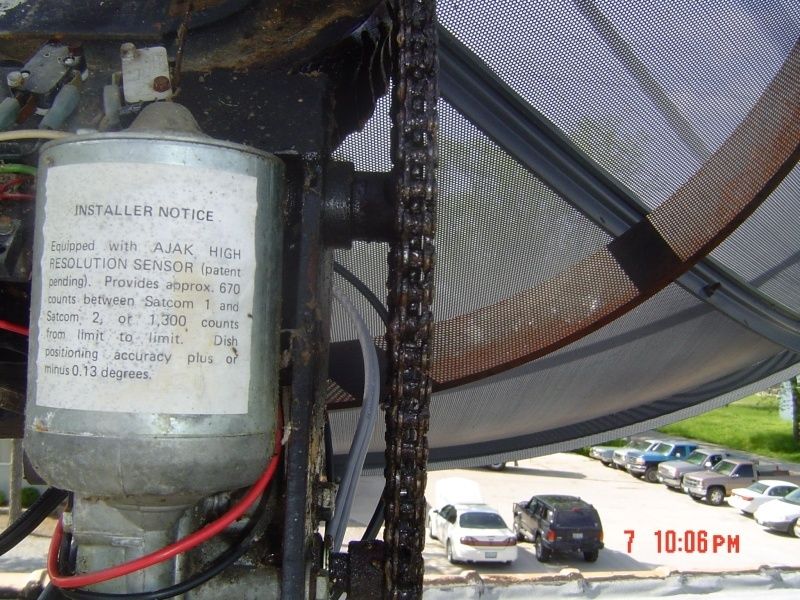

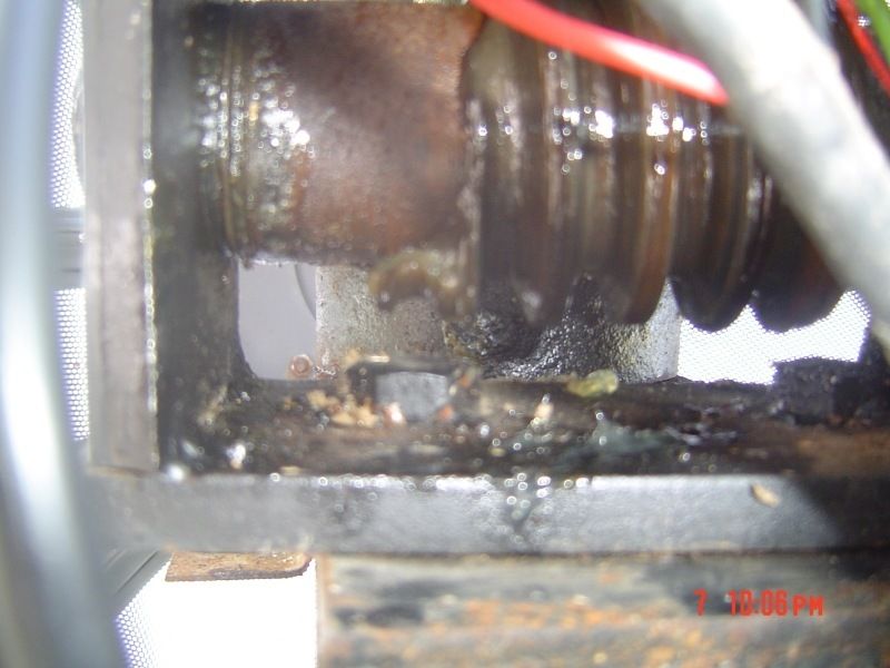

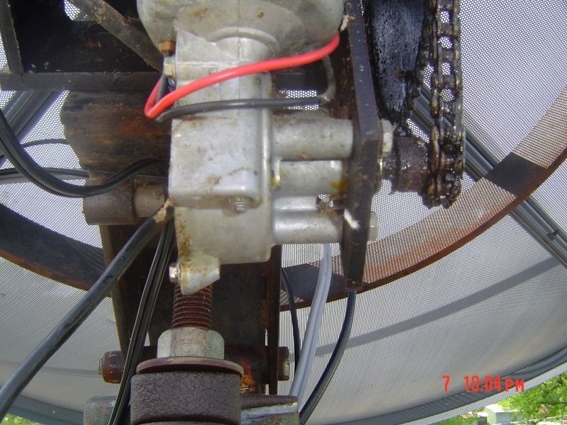

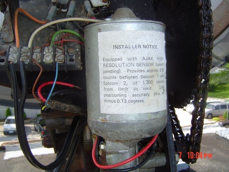

I wanted to post these close-up pictures of the motor and gears on the Pinnacle and ask another question or two.

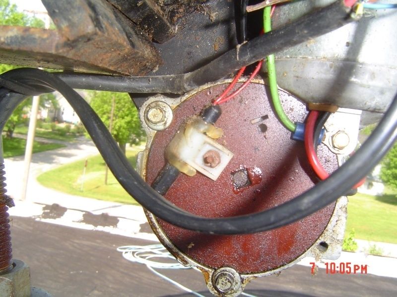

The one picture above shows a little masonite like circle that is held in place by 3 bolts and washers. You can look at the corresponding picture and see that the bolts don't go all the way through the motor.
Is it possible to take out those three bolts, slip off the masonite circle and access the gears to lube them up good?
I don't want a lot of things to come shooting out at me, but would at least like to check how well the gears are lubed.
The pics of the various shafts also give an idea where a better sensor might be mounted.
Thanks,
Fred
....little masonite like circle....
Hey Fred:
Correct me if I'm wrong, but is that the reed switch attached to the plastic plate? If it is, then the stator (magnet wheel) is behind it, and you would rotate the plate to fine tune the reed switch. The plastic plate would set the gap between the stator and the switch.
Doubt that there would be any way to lube anything behind the plate, but you could mark it, take it off, and see.
Harold
Hey Harold,
I think you are correct. If you look at the one picture of the terminal strip beside the motor, you will see on the top side from left to right, orange, white, red,green,and red.
Then look at the picture on the plastice circle. The red wire/wires/ end at the sensor, and the green is a ground.
I suppose it is possible to fine tune the magnet wheel. I haven't ever done it, nor do I know how to proceed. It doesn't appear to be skipping any pulses. Stops and starts at the correct place every time.
I might mark and pop off the circle just to see if there is something that can be lubed in there.
