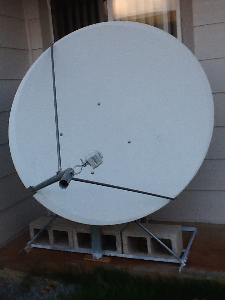

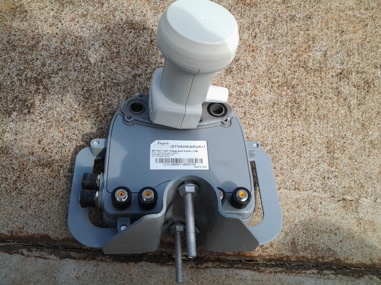

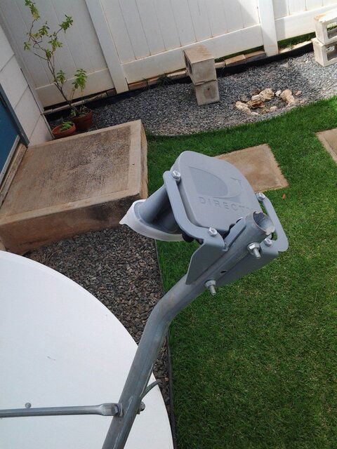

I did find some alternatives and wanted your feedback. Locally on craiglist, there are few ads selling 1.2cm dish for $50 that are originally made by and for direct tv (click picture to enlarge). This is the most common dish on the island. My question can I change the Direct TV LNBs to a standard LNB easily?

Yes, the LNBF can be changed. I'd get the Ku PLL model:
http://satelliteav.com/p/shop/?ws_pid=1613&ws_cat=433
No, I don't think circular reception will do you any good.

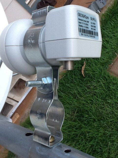

Thank you gentlemen for you advice thus far. Once reading the responses, I started to go after the parts for my 1st FTA build. I picked up GeoSatPro SL1PLL LNBF and a GeoSat MicroHD. I had no success yet with the Craigslist ads DTV 120cm yet. Eventually one will turn up, but I am anxious since getting some of the parts. So, I started to look at satelliteAV inventory and other sellers on eBay comparing prices/shipping costs to Hawaii (shipping usually costs more than the item). Here are my new questions:

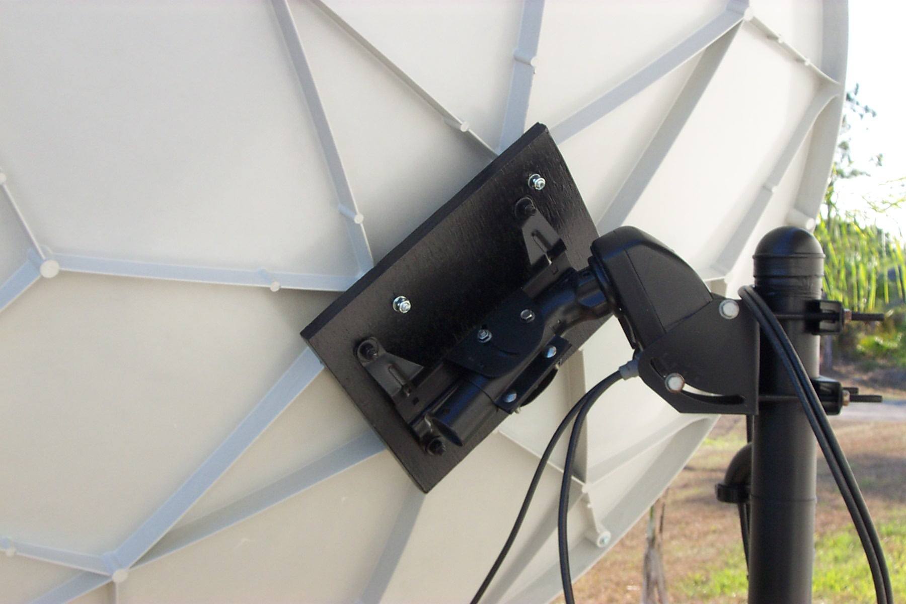

2) I wanted to get a motor - which one is recommended? I been reading descriptions that say made in Italy, plastic gears or metal gears.

2) Have read many members recommending the STAB HH100 & HH90.

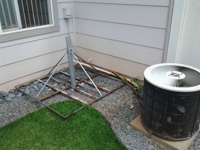

Buckets of cement are a nice easy solution for a temporary set up. More permanent would be a base approx 1.5 times the dish width weighted with cement blocks/ sandbags etc. examples: BAIRD NPRM
Home made pallet NPRM:
But even these tend to "move"
http://www.dslreports.com/forum/r16569875-DW6000-frequently-have-to-power-cycle-to-reconnect
Metal is the best, although, I have a 1.2 on crossed 2x6's. I do notice some degradation when it "moves".
Think a deck post, holding up a deck, may move less, as it's attached to other 'parts'.

As for motors... STAB HH90 for 90cm.
Your 1.2m dish would need a STAB HH120.
If those prices are out of range, consider the DG320 from Sadoun for the 1.2.
