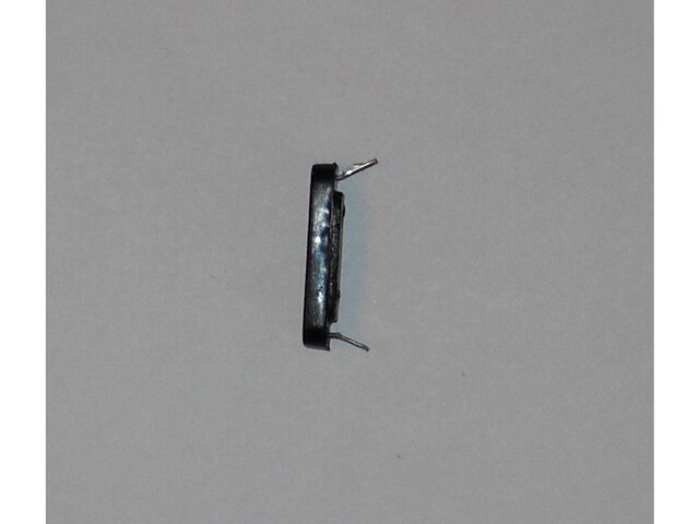

Here is a picture of the reed switch. I took the leads off to hook up the temporary replacement.
Sorry, I forgot about this but yup, that's the same one I have here. I think they are still available as I purchased one a couple of years back but can't remember where.
