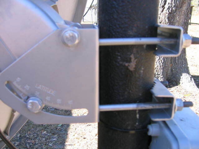

Install was straightforward as with any other motor, but when you do that you will quickly notice that this NOT just a SG2100 with the Satellite AV name on it. The bracket is more robust and plated for corrosion resistance, and the u-bolts themselves are bigger than you get with a standard SG2100, I would say that they are 3/8 inch u-bolts instead of the 5/16 bolts that come with a SG2100, plated as well. The bracket also has the LATITUDE stamped on BOTH sides instead of confusing folks with latitude/elevation stamped on opposite sides of the brackets of other motors. Again, attention to detail that sets this product apart. It also included easy to follow, well written instructions for those folks that have never installed a dish motor before. Nice touch.

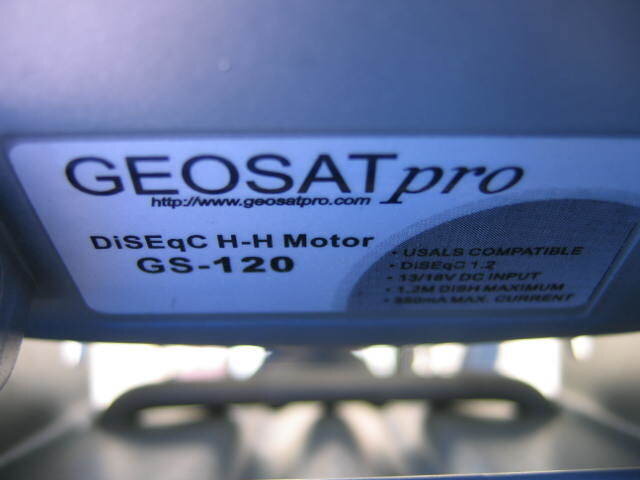

Attached below are a couple of pics of the motor after install.
